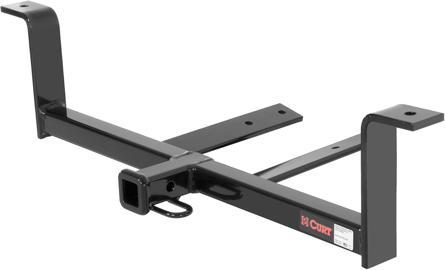

The holes look like they could have been used for a trailer hitch- Curt makes a hitch that has a mount in the trunk- unlike the wicked good hitch made by Chase Race.
In this case, clean the trunk and prep for POR15. Then look for rubber body plugs to fill the holes.
darcy
I think you are right...

I am guessing previous owner either
a) installed that hitch ... which looks like a terrible design to be honest using the trunk pan for its mounting points ...
b) had clogged drain lines and could not figure out why water was always in the trunk and then tried drilling drain holes vs fixing the issue
I would sand it well (including getting any rust out of the edges of the holes, POR it well and possibly find some new plugs or seal it up well. Be careful though not to create a place to trap moisture by sealing it up.
