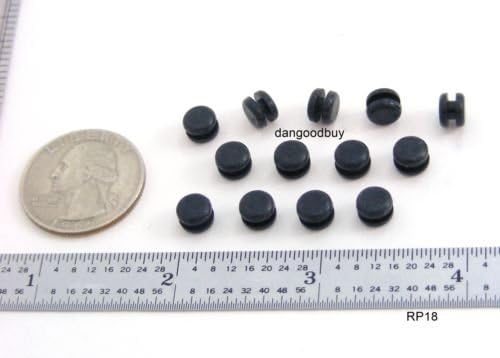

">Maybe these? <img src=" /> ">Maybe these?
< That's a link.
I'd still clean out and prime the holes.
-- Chuck

Just checked, seem to be drilled with 3/8" drill bit.
I'm considering these:
Amazon Link Amazon Link
and using the 9.53 ~ 3/8.
They look like they are meant to be used as a grommet for wiring, but they should work.
The others may come in handy in the future
