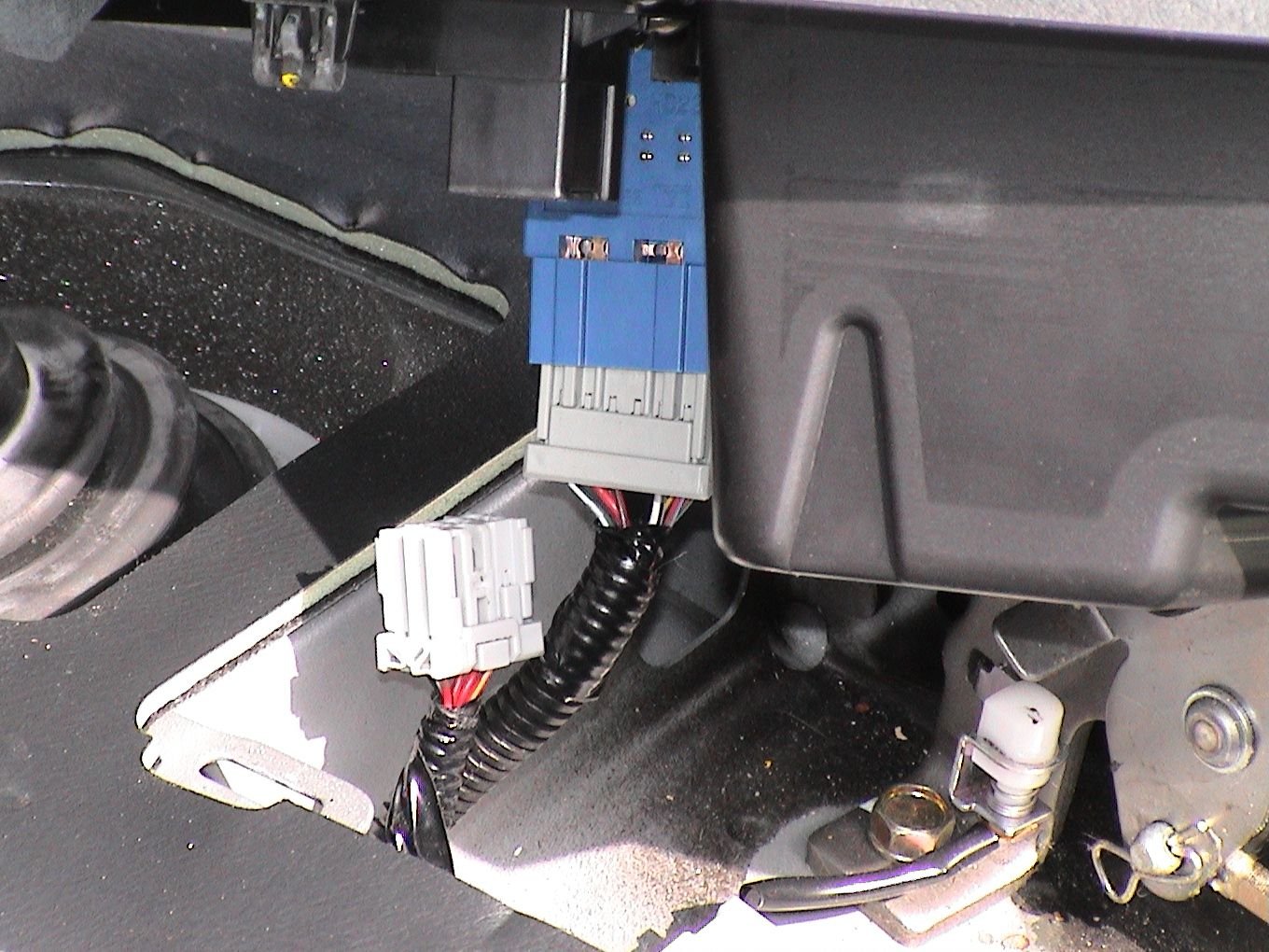

There are two plugs that require squeeze and separate. Note that the emergency flasher switch the white separates from the blue.

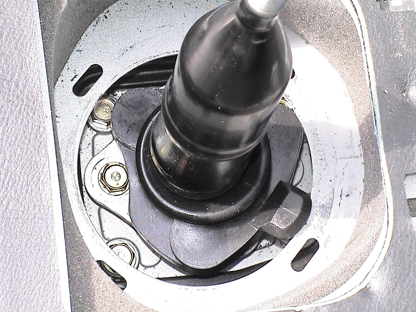

Looking down into the opening for the shifter you will see a rubber boot. It has four clip holding it in that must be pulled up. (No picture) This will expose the second rubber boot over shifter bolts as seen in the following photo. Ignore the four bolts seen in this picture, the ones you want are under the lower rubber boot.

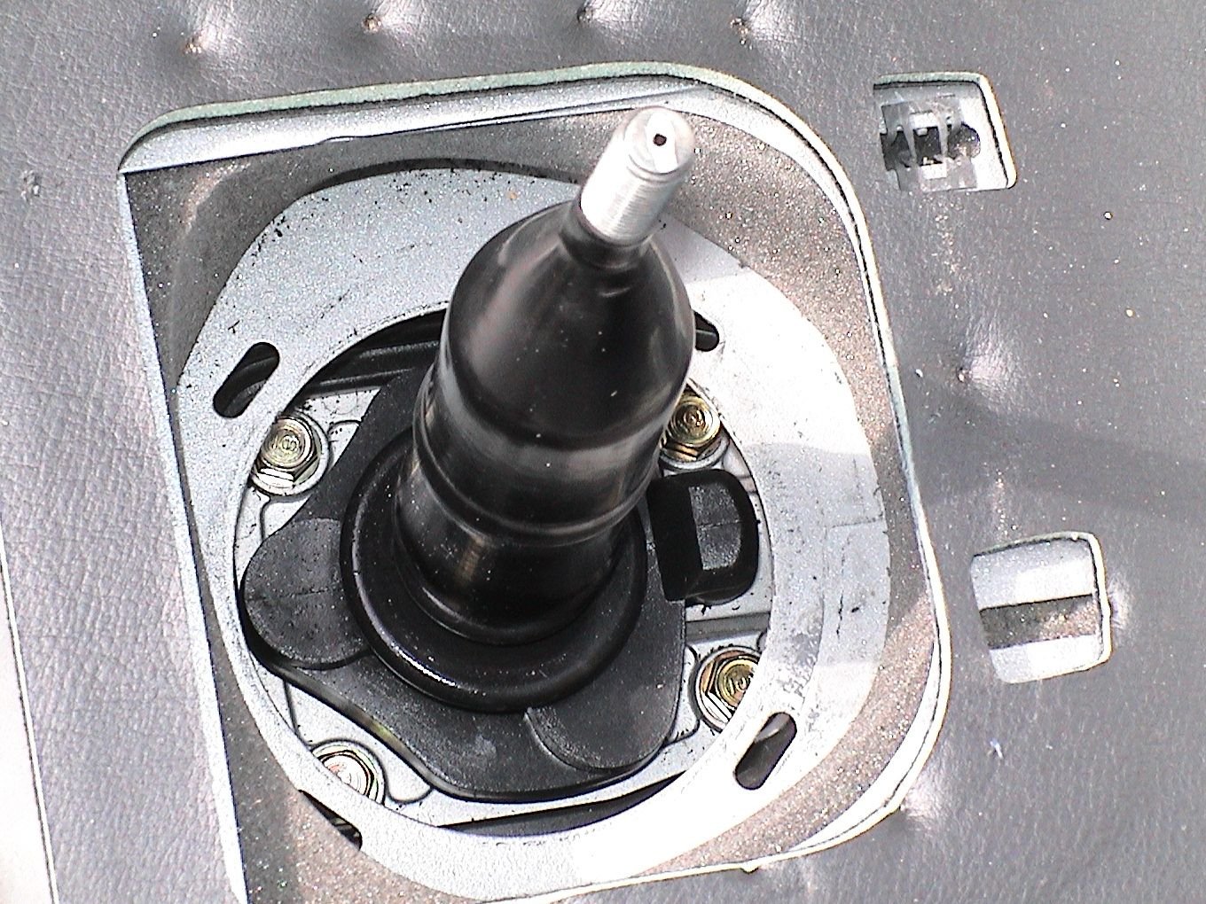

The lower boot is pulled back to reveal the bolts we need to remove.
With the shifter in neutral, remove the 3 bolts and pull the shifter straight up. Leave the greasy spring in the hole to avoid the mess. The shifter is greased very well.

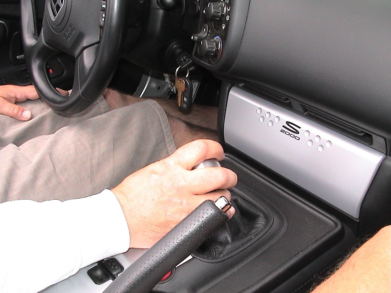

This Vodoo knob sits about as low as you can go.
