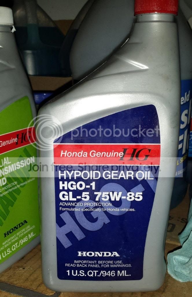

If the dealer did give you the wrong diff fluid, it will destroy your diff in short order. So take this seriously and check it out asap.
The reason dealer would make this mistake is all other Honda's use the same diff fluid, and many at dealership have never worked with an S so they don't know it uses something different.

What i meant to say, i drained and refilled diff with new oil to proper level.

i believe thats the wrong one. No US honda dealers carry the correct gear oil. our diff specifies for a SAE90 or equivalent. take that out of your diff. go buy amsoil, LE, or castrol. or what ever you prefer. ive read on another thread that may work, but its below the minimum required spec. just my .02

Purchased this stuff today.
I couldn't find the Amsoil or LE.

thats better than what you had. people run that and like it so you should be ok. LE is harder to get, i just sign up as an amsoil prefered member.

Nothing wrong with the Honda fluid you picked up, it's GL5 and that's what the car requires. The viscosity is a bit light, but otherwise you're good.

Added the Mobil 1 oil to diff. I noticed a bit of oil leaking where the passenger side drive axle goes in the diff. Maybe seal going bad. Easy fix?
