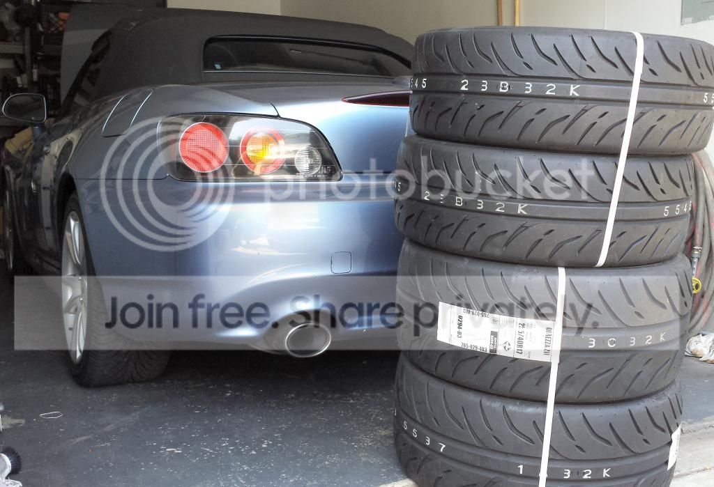

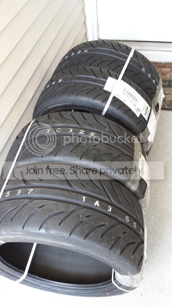

Old Jun 17, 2014 | 02:04 PM
  #29
Bricktop ivi's Avatar
Joined: Mar 2014
Posts: 94
Likes: 6
From: Richmond
Update:
With new Direzza ZII fitted all around, the car feels much better. None of that slight shifting to the side business.
** Also replaced the 4 diff mounts. (Thanks, Billman)
