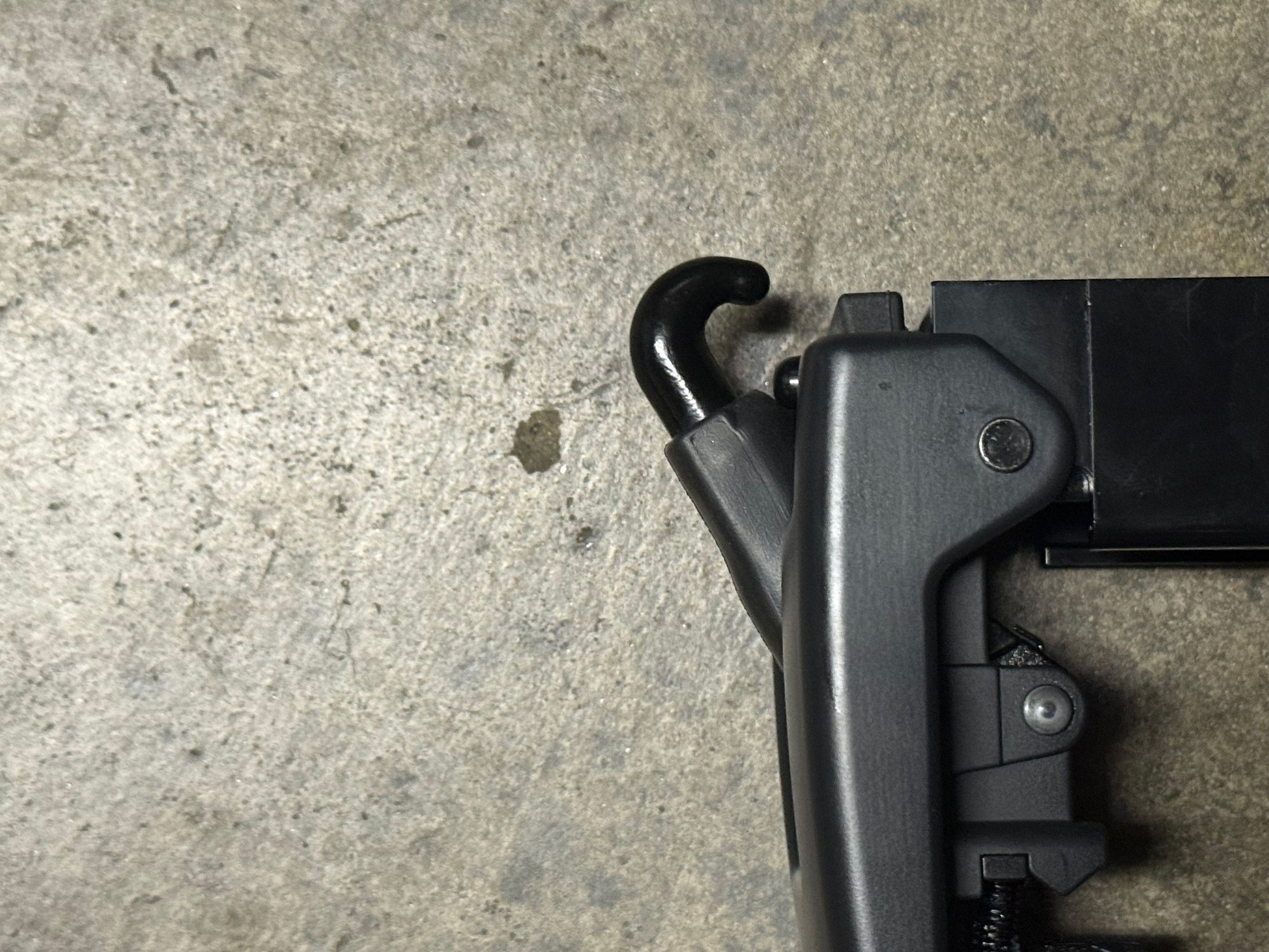

Side by side this is the latch
Side by side this is the old latch
New latch
New latch
it’s barely noticeable but the old one is a little longer why is this ? on the new one I can’t put my ring finger in between the gap but on my old one I can.
Old Jul 24, 2025 | 04:35 AM
Chuck S's Avatar
Joined: Jul 2014
Posts: 13,806
Likes: 1,540
From: Chesterfield VA
I now suspect you currently have the earlier, longer latch on the car which for some reason was installed some time thru the ages. The fact the part you just got (which is the right part number) is excessively tight indicates you need the earlier part.
Previous part number was 86260-S2A-013 which was for the early 2000-2001 cars (with the plastic rear window?) and seems ti be longer as I've seen notes that for a tighter fit you can fit the hardtop strikers. I'd try that part.
But I can almost get two finders into the latch on my 2006 car when it's open so who knows?

Originally Posted by Car Analogy
Maybe there was some problem that occurred, and po fitted these older, longer hooked latches to solve it.
So now one breaks for unrelated reason, you go to replace with correct part, doesn't fit bc of whatever that issue back then was.
No Idea why these are on here but I've concluded that it made contact with the bar that's supposed to retract with the straps on the soft top. I saw that because the bar didn't come down it created tension with the latch and broke it open. This would've actually happened even with the new latch I got since its the same size as the old part besides the hook. I also already ordered new straps for the soft top.
