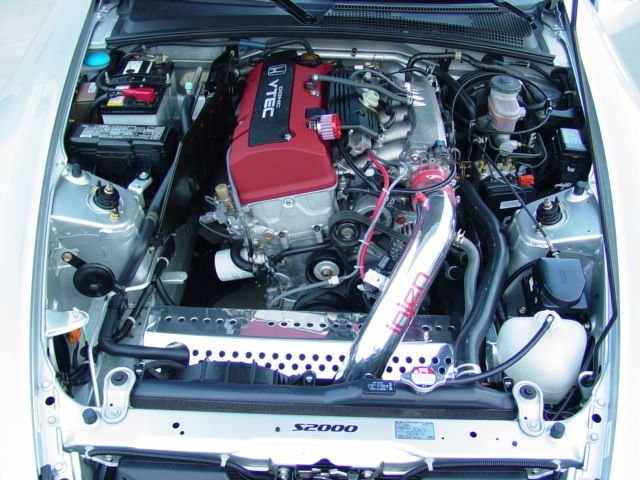

Does anyone have a pic of their engine bay with a CAI installed? I'd like to see how mine looks compared to anyone else's to see if it looks right. Thanks!

Old Jan 15, 2003 | 01:59 PM
speed4tu's Avatar
Joined: Oct 2001
Posts: 3,663
From: Greenville, NC
BTW here is a pic of my Injen, although I am not sure you can see what you are looking for.
