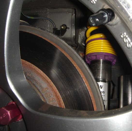

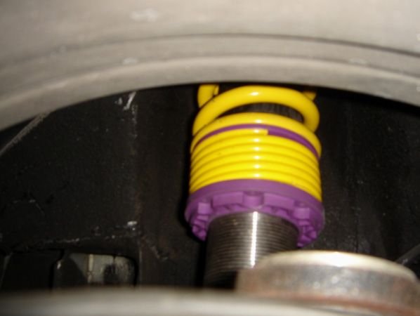

pics speak for themselves, are the springs supposed to be like this? or did i raise the height adjustment too high? what should i do? i don't want to slam my car again because i want to start autocrossing the car. anyone got any ideas?
FRONTS
REARS
thanks in advance

those are helper spring, they can be compressed while the car is on the ground but if you lift the car up in the air, those sucker should not be compressed all the way stacking like this.
the reason for the helper spring is to have the spring seated all the time, esp when the corner is unloaded.
yeah, jack up the car and see if they will uncompress itself, if they are still stacking after you jack the car up, you have too much preload.
also, they looks pretty new to me, check with KW to see if there's special "break in" steps to do, preload, etc

It's normal for the KW's helper springs to be fully compressed with the car on the ground.

Originally Posted by PeanutButter,Jun 19 2007, 09:41 AM
Isnt the helper spring suppose to be on the top anyways
Nope. The purpose of the helper spring is to keep the main spring against the perch should the suspension go full droop. Therefore, it must be on the bottom to work.
I found that my helper springs (I have KW-V3's as well) were fully compressed after install but settled out a bit once the main springs relaxed some. I am not slammed either and have been actively AutoX'ing all season.
