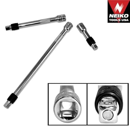

Speaking of Sears, I got a Craftsman LOCKING extension and it solved any problems with sockets coming off. No tape needed. You have to pull back on the little lever to unlock it. Wish I knew they existed sooner.

http://www.amazon.com/gp/product/B00123QN3M
I picked up these locking extensions about two years ago. They work well.
