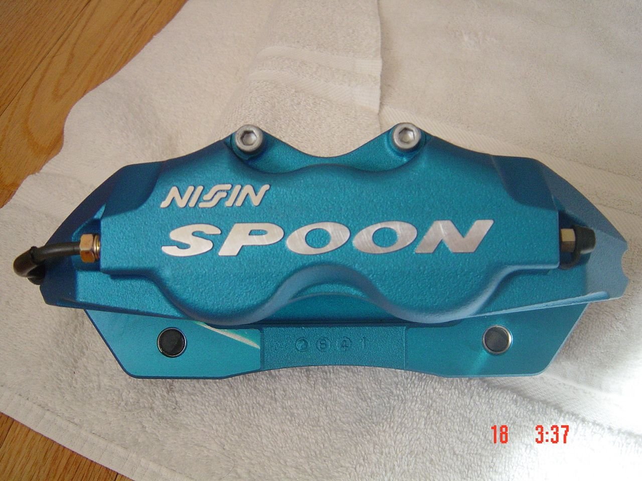

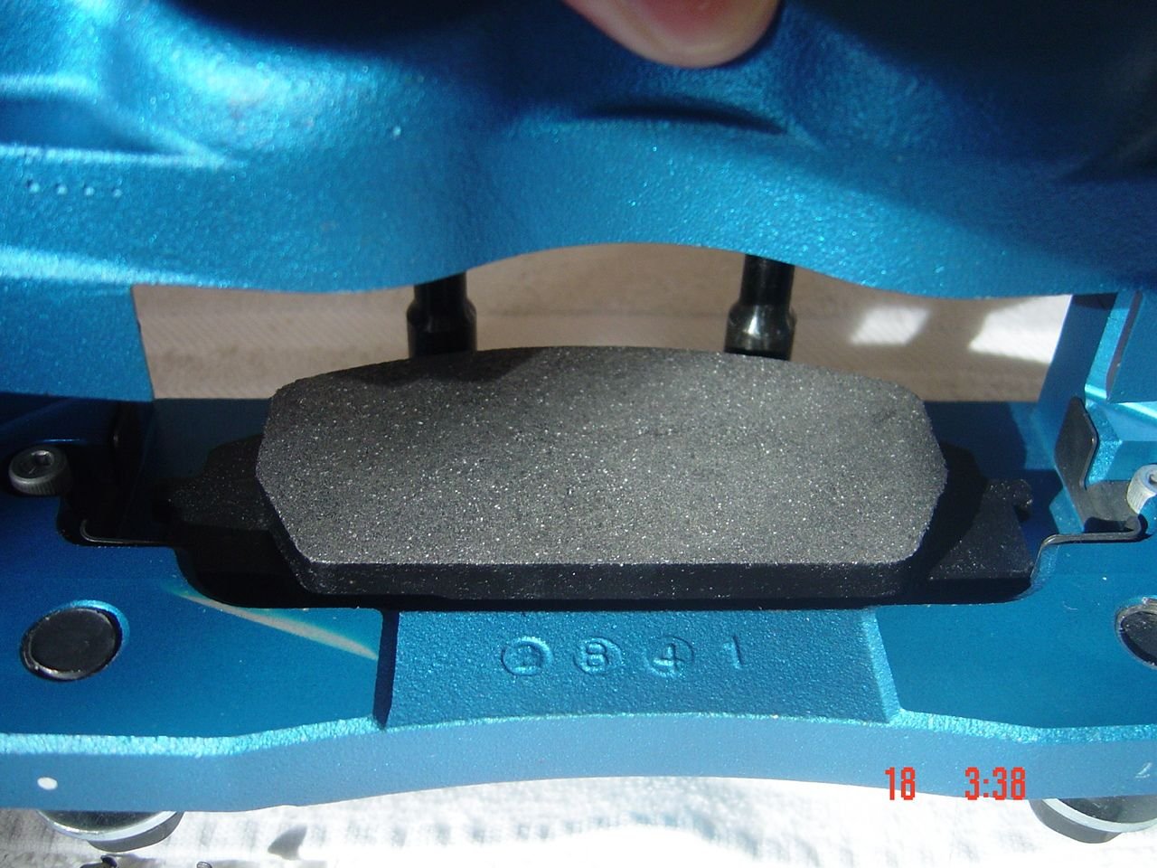

Hi I try to install the caliper today and just realize that the stock pad is not fit the spoon caliper. the Brake pad seem to be smaller to fit in the caliper perfect can anyone help me what pad should i get. thank you

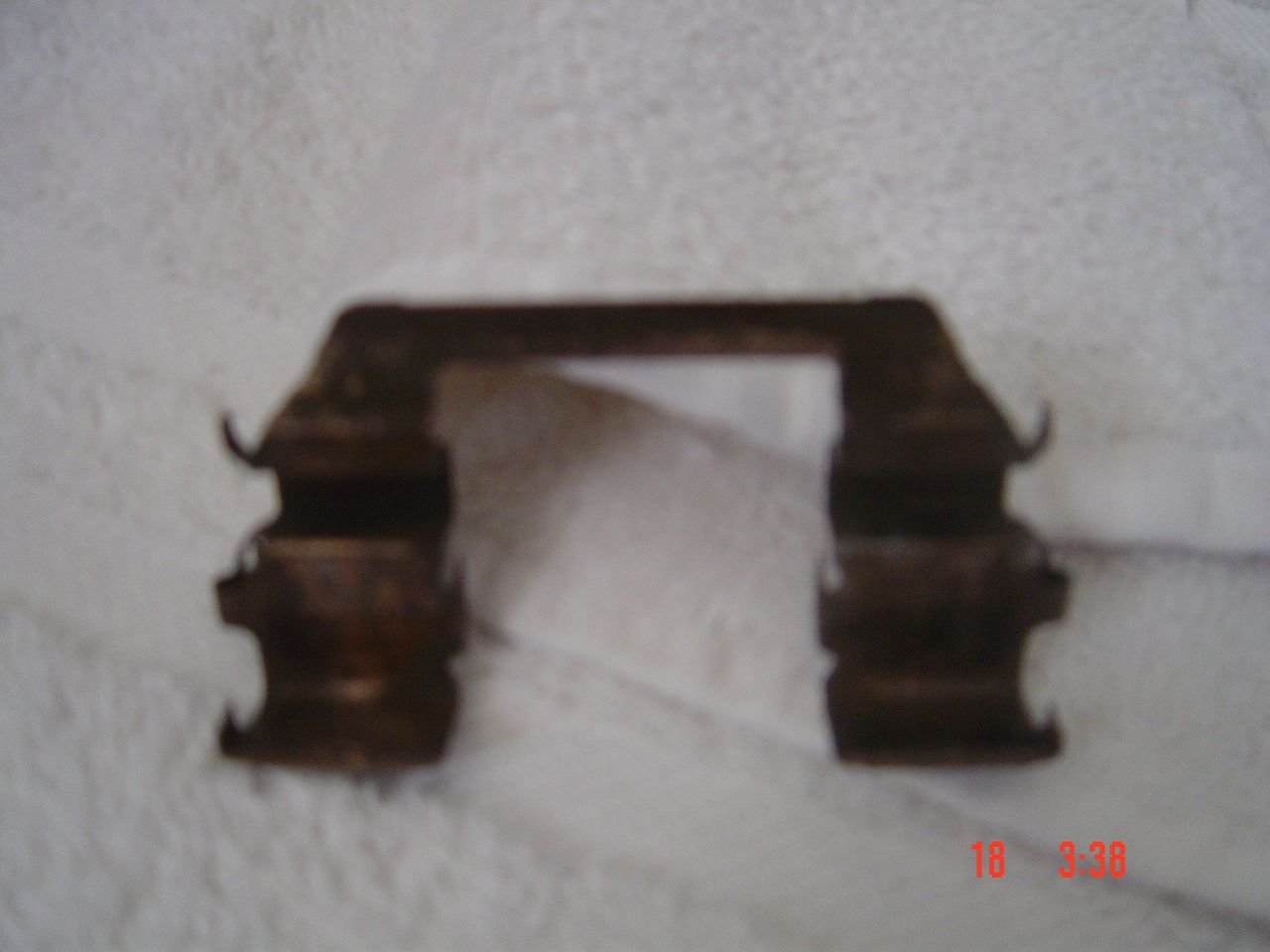

The stock will fit to the Spoon calipers but you have to take off (cut) the clip thingy and the backing plates then you can have the pad go in smoothly.

Unless you get the mildest endless pads and the car is driven on the street, I don't see a reason why you couldn't run stock pads. They are cheap and don't dust very much and work out great. Just take a dremel to the backing plate and remove the 2 clips on 2 of the four pads. Not a big deal at all.

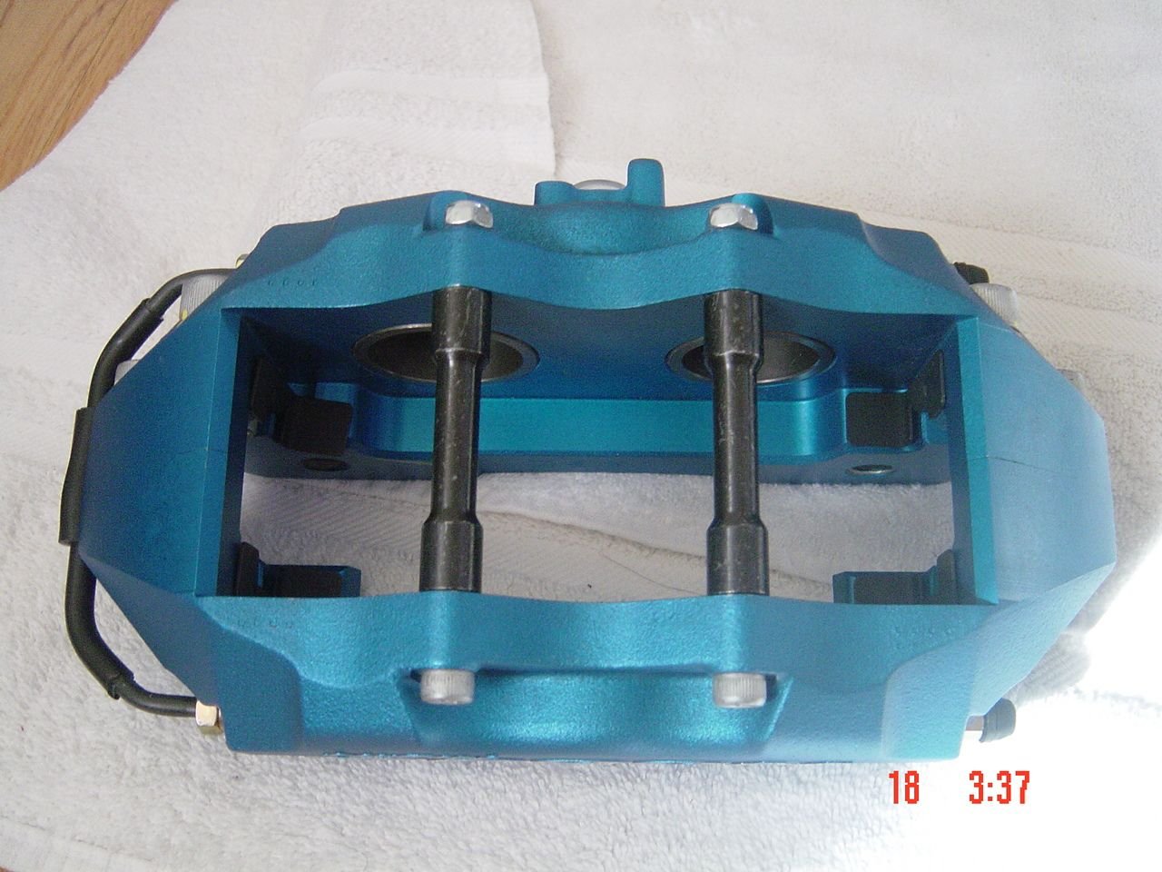

IS this the right spoon caliper to fit the S2000. Also you guys mean the reatainer in the picture that i have to cut.

ahhh, you got the wrong calipers. Those are the older calipers for integra/civic. Isn't it weird how they have to run such a large pad? Anyways, sell those calipers and get the right ones.

Vapors is correct. Those are the old civic calipers.. Stock pads will work as AJ mentioned. All you have to do is cut the metal reminder tab off.
You need the 4 piston monoblock calipers with the AP1 bracket kit.
