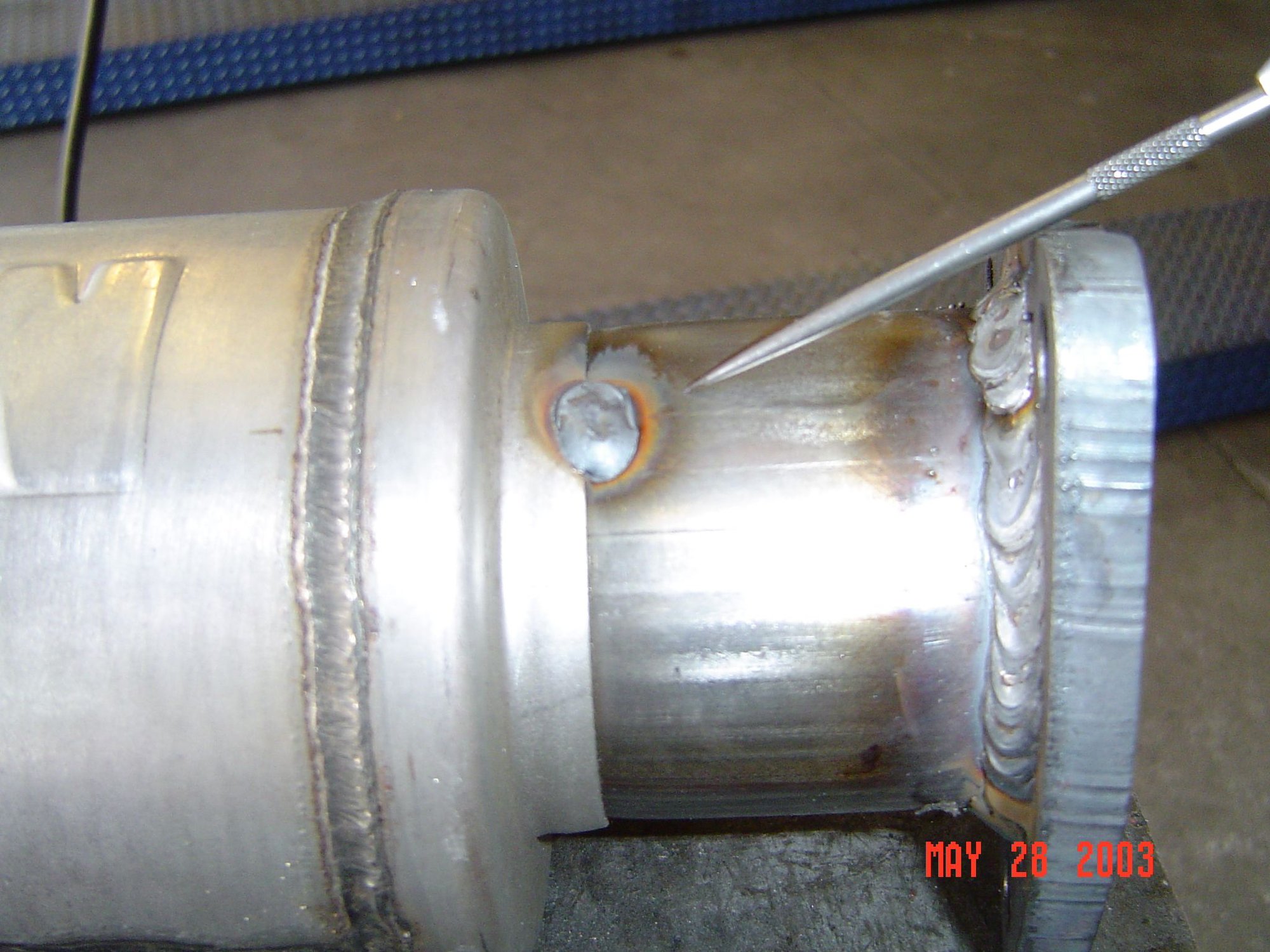

I have a spugen dual exhaust and the magnaflow resonator they use to use is making a loud vibration noise... like the inside chambers or whatever broke off and now are vibrating against the piping... it gets very loud and annoying at times. Has anyone else had similar experences with this problem. Im half thinking if just cutting out and welding a new resononator in the place of it. Is this an issue that i should take to Spugen?

Bring it by the shop. Magnaflow had a bad run. THis is all that needs to be done and all will be fine. Let us do it for you.
Duc

thanks Duc, the thing is im from ohio.. could i possibly just ups it to you and you can fix it and send it back??? also it just looks like a small spot weld... if it is it would probably be easyer for me to take it to a place and have them weld it.

Sorry for some reason I thought you were in cali. Any muffler shop can fix it for you for less than $20. Send me the billok?
Duc

^ if that ain't good customer service I do not know what is! good man Duc! That is just a small spot weld, should take less than 10 seconds once they get it on the lift at any little muffler, welder or body shop.
Matt
