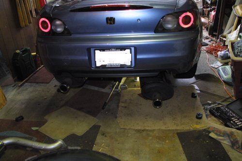

Here are the pics I took during my Spugen exhaust install this afternoon.
Before
The new parts
Up on the jackstands, ready to get started

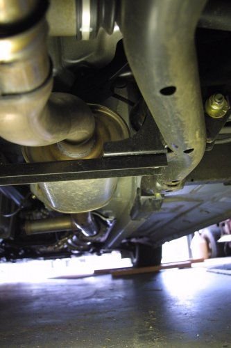

Remove bolts on right side of rear tie bar:
Remove bolts on left side of rear tie bar, then remove the bar:
Remove the 3 nuts at the cat.
After unhooking the hangers for the mufflers, leaving just the hanger at the resonator:

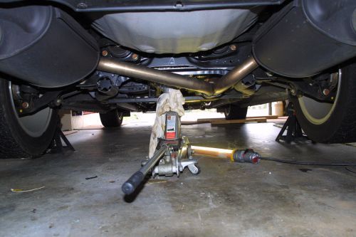

Exhaust removed:
Stock exhaust:

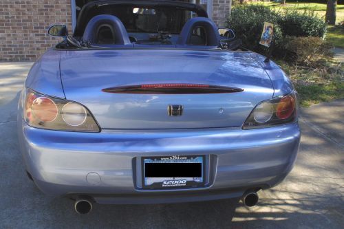

Spugen exhaust installed:
After -- I'll get a better picture tomorrow:
