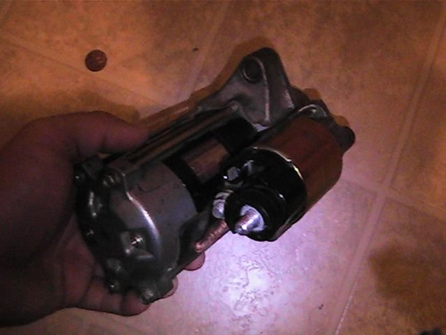

I got a couple questions as I am going to start tracing the wiring and trying to find a fault. As an inital test I was going to test the leads that attach to the starter and make sure power and enough of it is present at that point before I start working backwards and trying to find the problem. I took a pic of the starter I pulled and wanted to double check with you guys what I should be looking for in regards to the leads that attach to the back of the starter. In the pic the green circled A lug is where I assume the power enters the starter... so when the key is on and the start button is pushed the lead that connects here should show 12v... am I correct? The spade terminal that pushes on just above the bolted down power lug is marked with the red circle and the letter B. I am unsure of the purpose of this lead and therefore not sure what it should show when testing it with a volt meter or test light. Any help will be appreciated.
Thanks

I'll take the batt to autozone and have it tested... any help on what I am supposed to see at the leads that attach to the points highlighted on the starter? I'm going to put my volt meter on the leads and press the start button and I want to know what the "normal" reading or result should be... so I know where to start.
