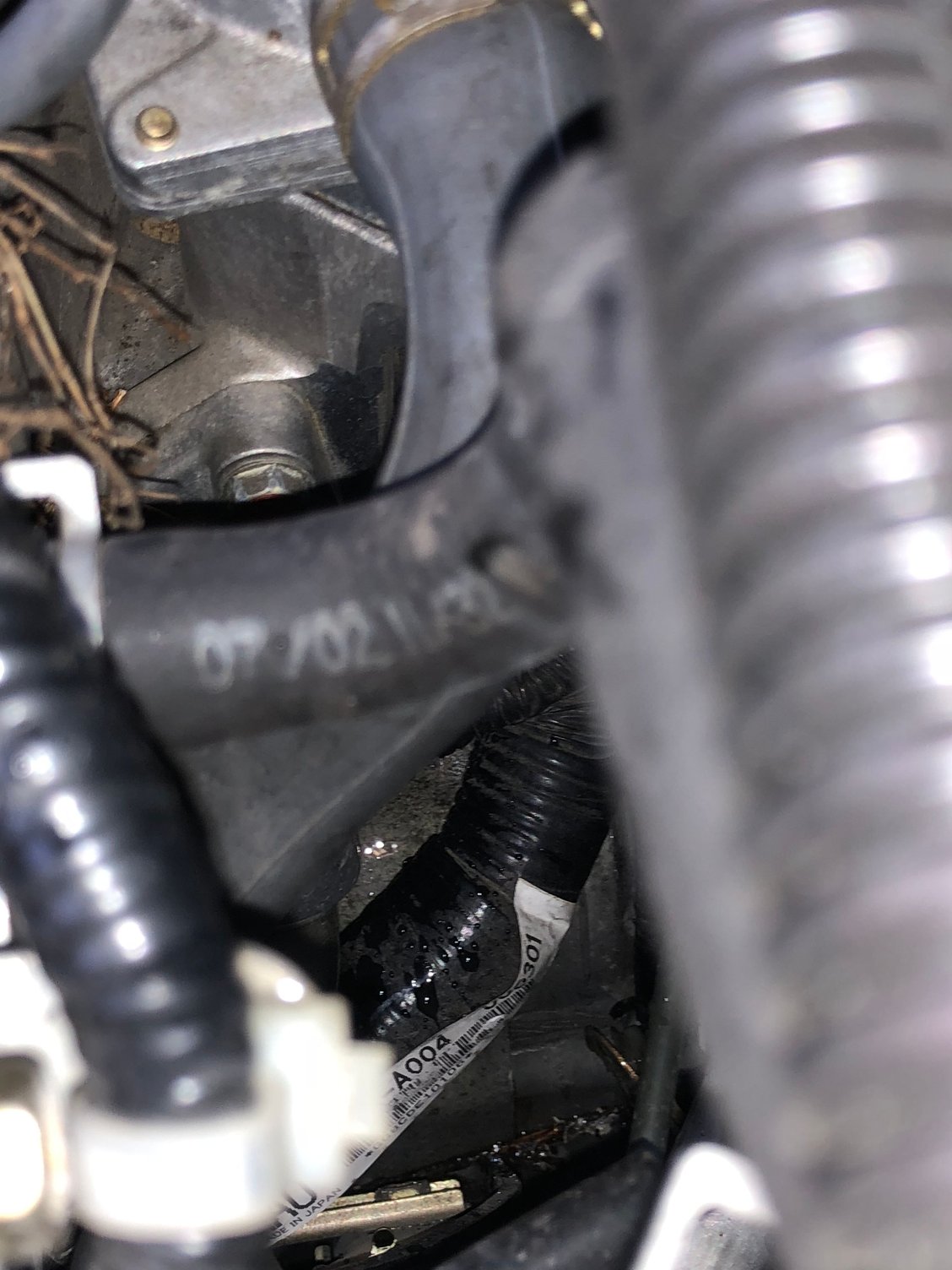

Whelp, I found the culprit after going and renting a pressure tester. I got it up to maybe 8psi before it started gushing out behind the intake manifold. I shined a light in there and could see coolant spilling out but couldn’t pinpoint exactly where, it’s just to crammed. How many coolant hoses are behind the intake manifold? It’s gonna be tough to get in there by my self. I’ll try and post pics.

Under the IM is the lower rad hose, and I believe there is a coolant line for the IAC, and under the throttle body over the alternator, behind the IM ie the firewall is the heater coolant circuit.

Yeah it seems like one right next to the firewall, can you see most of the lines from underneath the car? I haven’t had time to jack it up yet. Also, I’m guessing I’ll have to take out the IM to get to those hoses. Yes, I have a K&N intake, but stock IM.

All the coolant lines are under the hood, none of them can be reached from underneath except the lower rad hose and only at the rad. For the record you don't have to remove the IM to remove any hose, it just makes it much much easier to do so. But removing the IM is itself a pain in the butt, I think removing the alternator and belt tensioner will give you all the room you need to see what needs replacing.
You mentioned a k&n exhaust look for any hose that doesn't look OEM, I bet that's probably the culprit. It's usually the hose over the alternator.

Alright, thanks. Yeah, I really don’t want to remove the IM but if it can’t get to it or find it by just removing the alternator and belt I’ll just have to remove it. My buddy sent me a coolant diagram that will come in handy. k&n exhaust? Did you mean intake? Only thing done to the engine is that intake.
