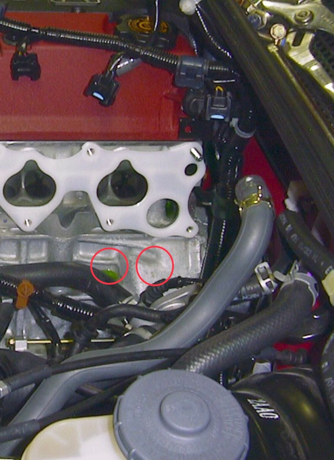

This is not my photo, but I was able to get a slightly better look at it from above the IM with a flash light. I was able to squeeze the top radiator hose and could barely see coolant squirt out in the two red circles I drew above. I bought my car with an intake spacer on it. Could this spacer be cracked? I was able to reach my hand around to try and feel if it was coming from a hose, but I couldn’t feel anything but coolant on my hands. It was squirting from where the right red circle is and pooling up where the left red circle is.

Was there an intake manifold gasket as well? It is possible when the intake manifold spacer was installed they reused the OEM intake manifold gasket, which will leak to leaks. I just encountered this myself.

I can’t tell yet if they used the oem one as well, but it looks like a blue one which I looked up and is the Hondata IM spacer, which I have read is terrible. So I will be going to oem if that is the cause and I’m probably going to replace my thermostat and other hoses that seem non oem just so I don’t ever have to take the IM off again.
