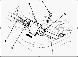

The universal joint connector between the shaft and the EPS unit is loose. It's right beside the AC compressor. there are two splined shafts that go into it and are tightened with compression. One of the two bolts which squeeze the splines is loose. The service manual details how to check and correct this.

I highly suggest you get a manual, without one you are flying blind.
You will need an alignment and you will need to reset the EPS unit neutral position but for a quick at home fix until then:
Center the wheels (as close as you can eyeball
Remove D
Loosen E
Slide the joint back toward the steering wheel (arrow), off the EPS input shaft C
Have someone sit in the car and hold the wheel dead straight
slide the joint back into place on the EPS input shaft C
tighten E and D to 16 ft lbs
