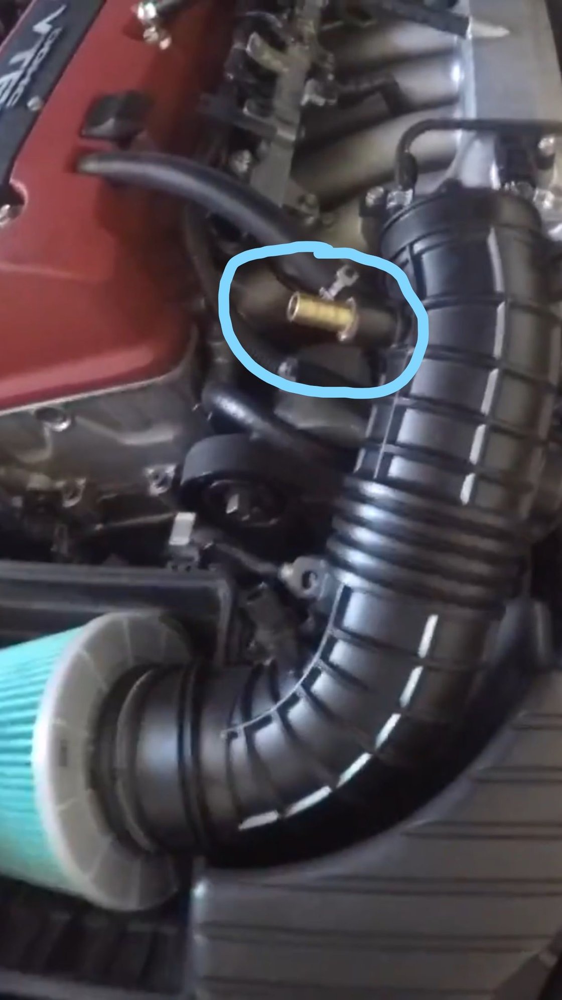

Hey does anyone know of this part number? The bronze tube extension to connect the intake to the valve cover. I've looked everywhere but everyone doesnt seem to have it which is odd. I've attached a pic and circled it. Thanks guys.

That is not an OEM part, neither is the hose that attaches to it.
OEM is a steel tubing assembly, that pushes directly into the hole that that brass fitting is in.

That hose near the bleeder is aftermarket. Those hoses have a 3 year shelf life, I would change it if it's stiff and not easily squeezed, once it starts deteriorating it's only a matter of time before it leaks.

Thank you kind sir haha, so I did order the right part apparently!
I guess my car had an aftermarket intake pre 2010 before I bought it lmao. Looks like its gonna be fun following the vacuum lines to see where they go tomorrow to make it stock.

Thats a random car off youtube i saw and thought it was oem haha but yup you right, cars gettin old and the rubbers getting brittle. Got a nice crack on the rubber intake arm nipple where the hose is connecting on the rubber intake arm. Whoever installed the air box back in lost this metal bracket tube assembly and got a larger hose and forced it over the intake arm nipple and threw a t clamp on it lmaooo. Never realized it was a tube over the intake nipple tube till I i saw the crack last week and pulled it off haha. Fkin a man lmao, I also ordered some new oem tubing when i got a new intake arm/braket so time to fix this arse holes quick fix lmao. thanks buddy
