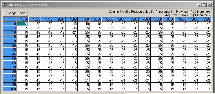

I seem to have fixed the problem. Looking at the E-manage maps there is a huge change from 0% to 5% throttle position. I simply brought the entire top row up to -35.
I guess the sudden change in the MAP sensor was confusing the hell out of the ECU and causing the stumble.
