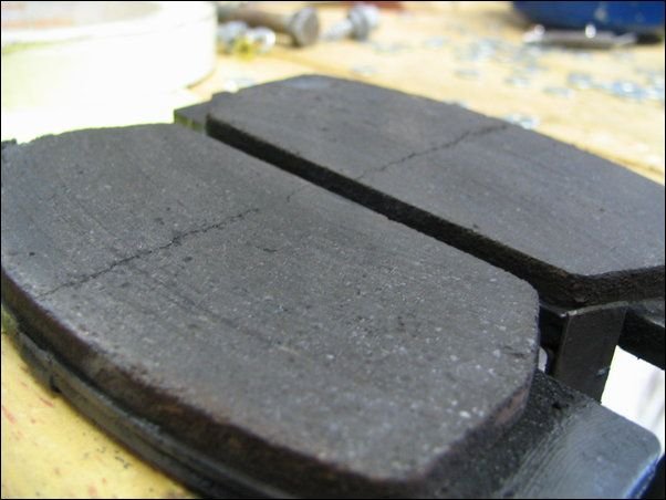

It would appear to be the pads. I pulled them and introduced the surface of the friction material to Mr. Benchgrinder. After re-bedding them, no more noise. One thing I did notice is a crack right in the middle of both the inboard and outboard pad that goes all the way to the backing plate. I'm going to go ahead an replace the pads, despite fixing the noise (for now).

If there are cracked that is the problem

But why did they carck?
Have you painted your calipers? Perhaps you have paint on dynamic surfaces. Both inner and outer pads are cracked exactly in the middle. My guess is excess caliper paint which has squeezed the steel guide shims.
