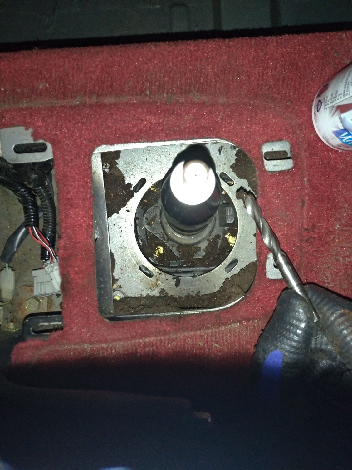

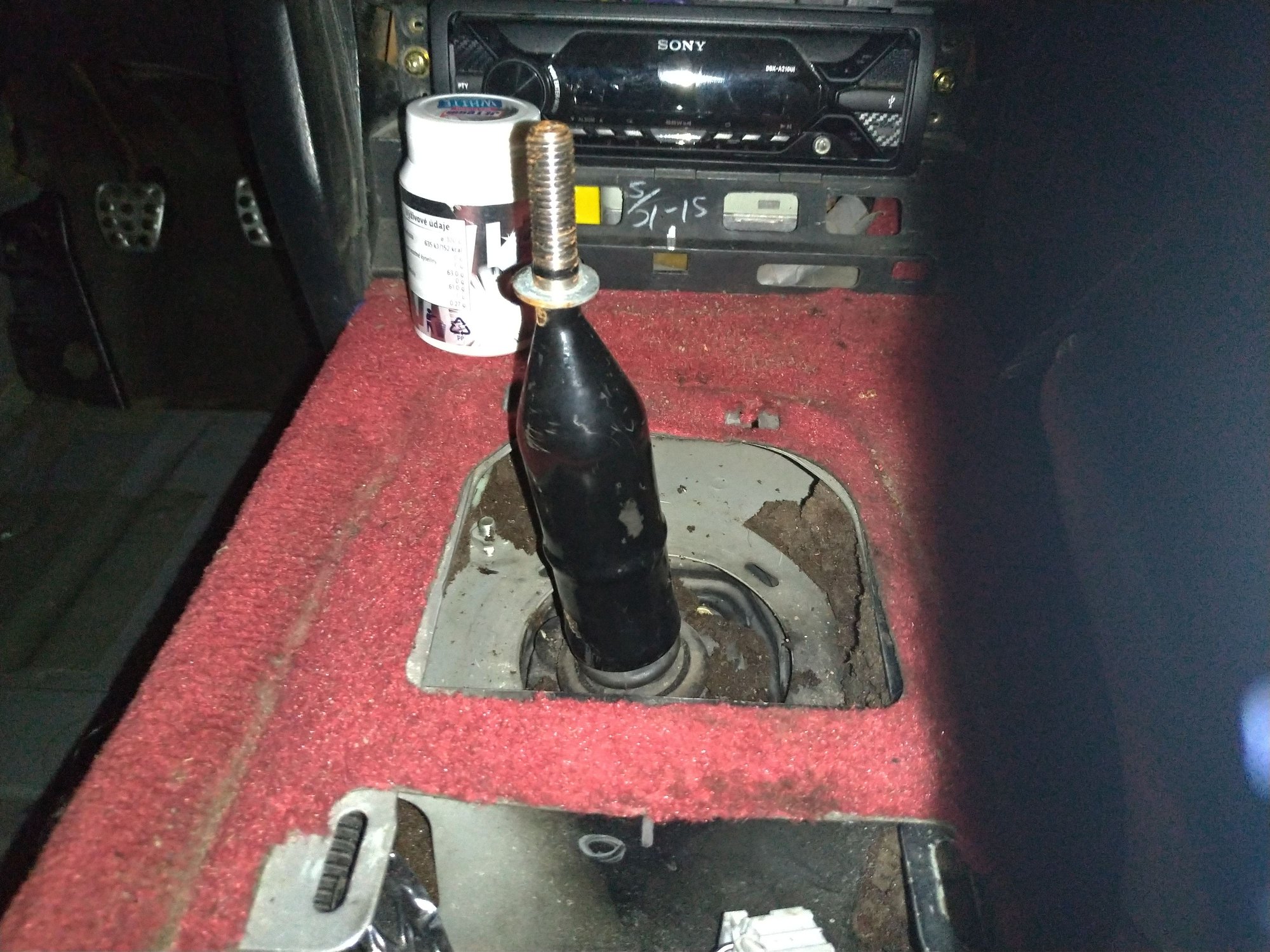

I recently roller my s2000 over the "roof" 3 times. I checked the chassis, needs some pulling and got the fender parts and all ready to be repaired.... I just noticed the shifter is not at the center and the bolts are misaligned. Is this indication of subframe deformation? I was under the car and the shaft seems to be in the middle. Are there any other pinpoints I can look to see if the engine is sitting on the place it should be sitting?

That's normal.

Yeah, that's a torn mount for sure. I think the engine should be sitting on it, not pulling so something else might be out of whack too. BTW check the other one, if it's dirty from that brown stuff, it's torn too.
The shifter is normally a bit skewed to the side, and is bent so that the knob is upright. In your case it's probably more then it should be which I couldn't tell from the photo.
