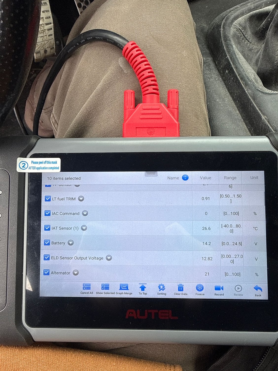

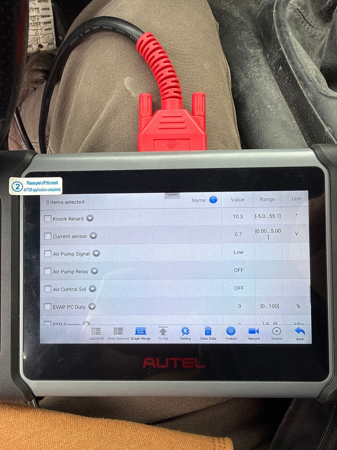

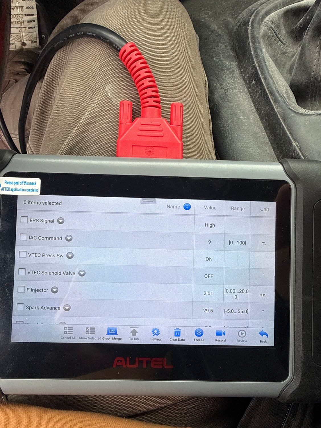

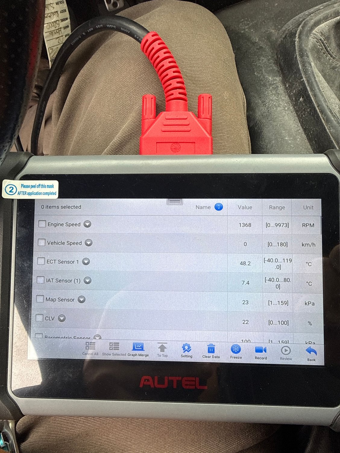

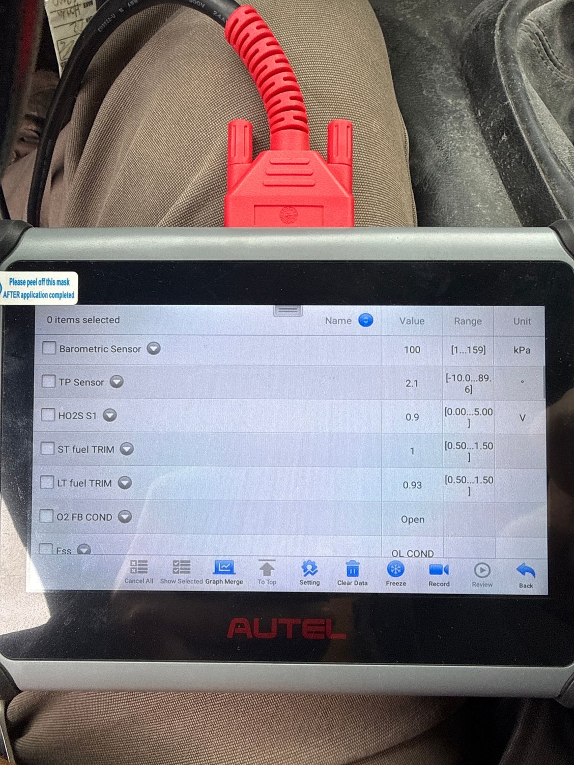

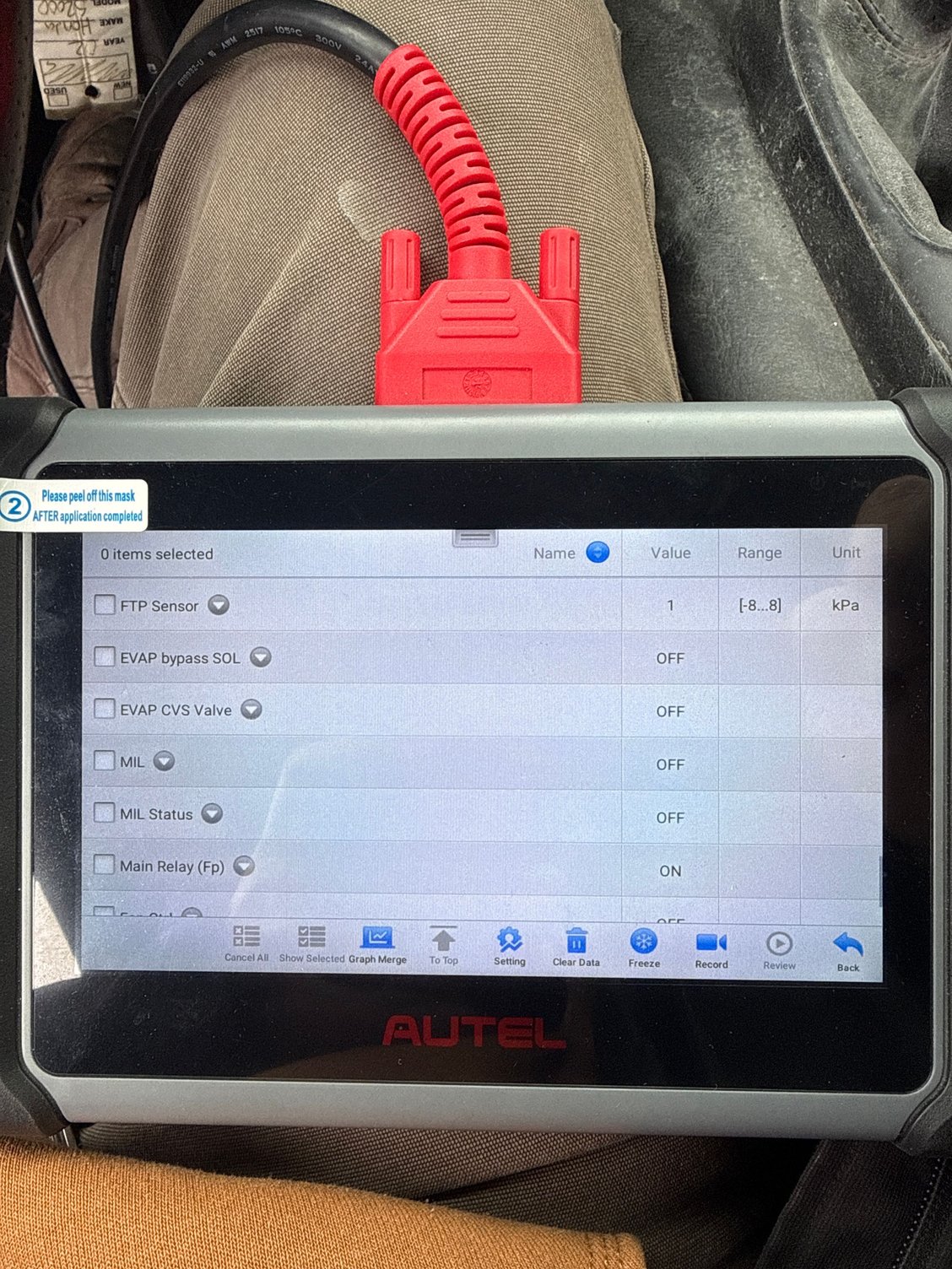

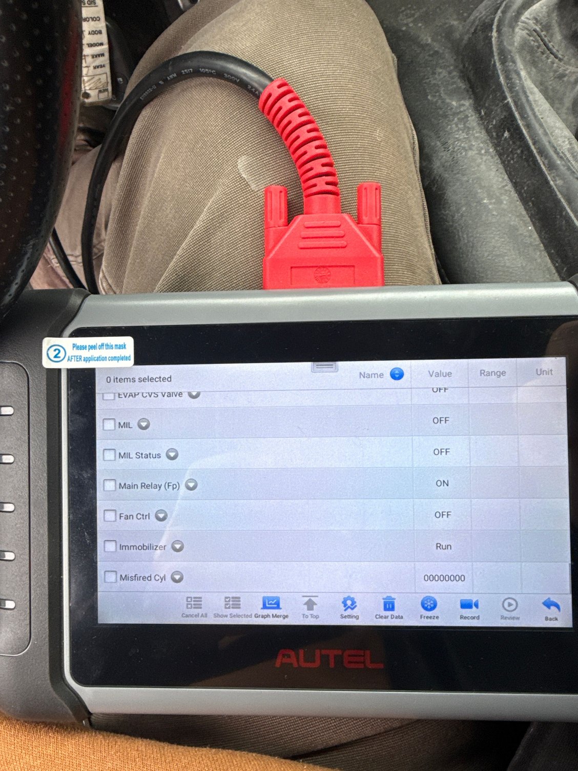

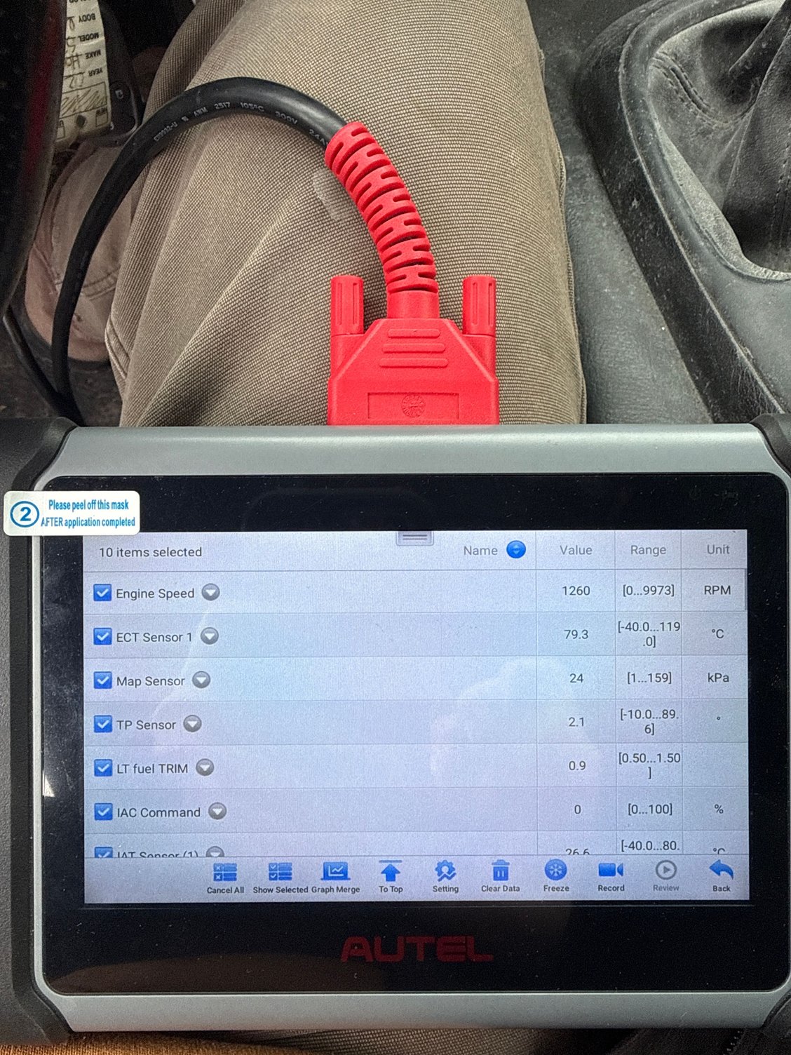

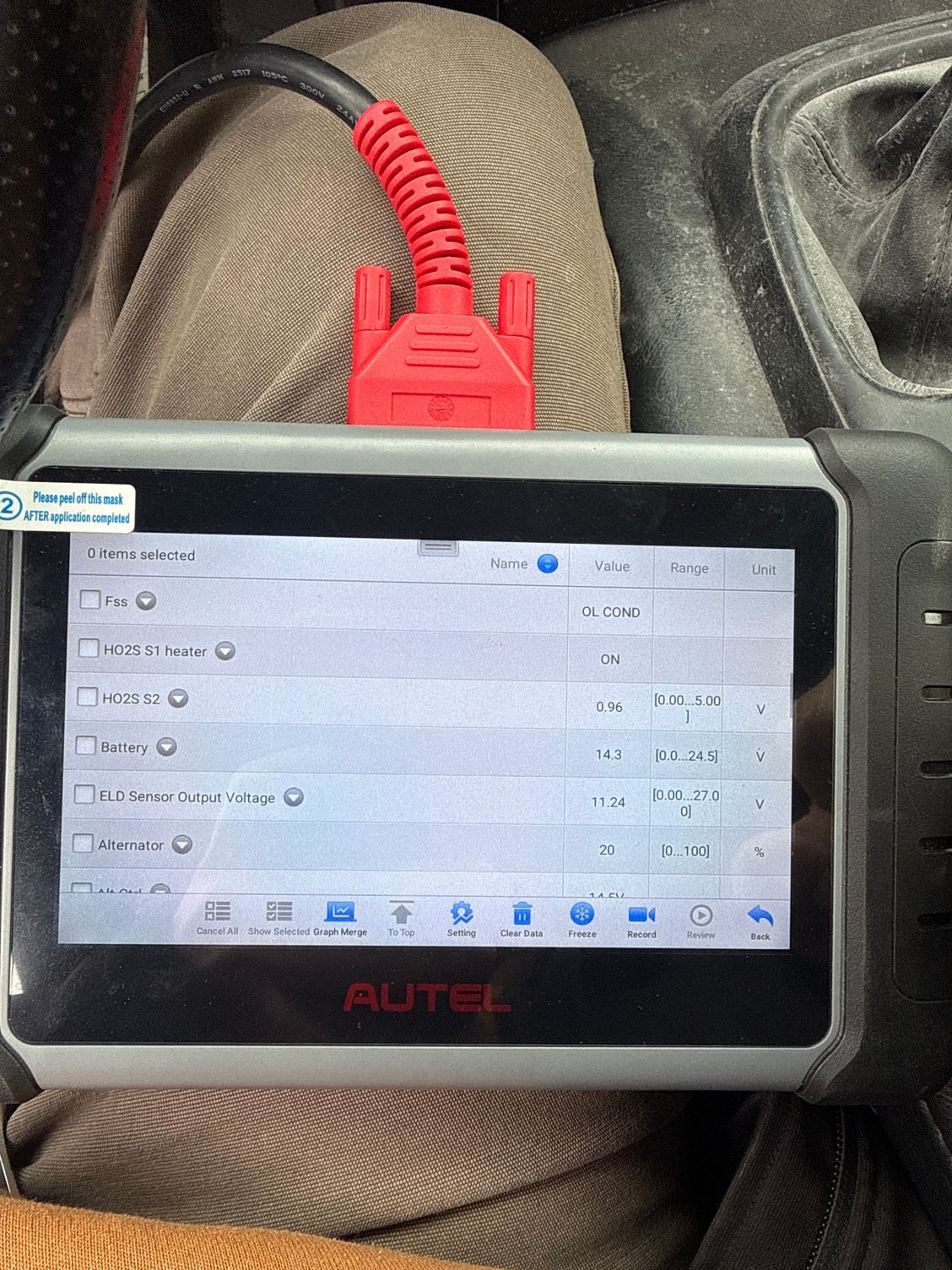

here are some scanner photos of the engine running
