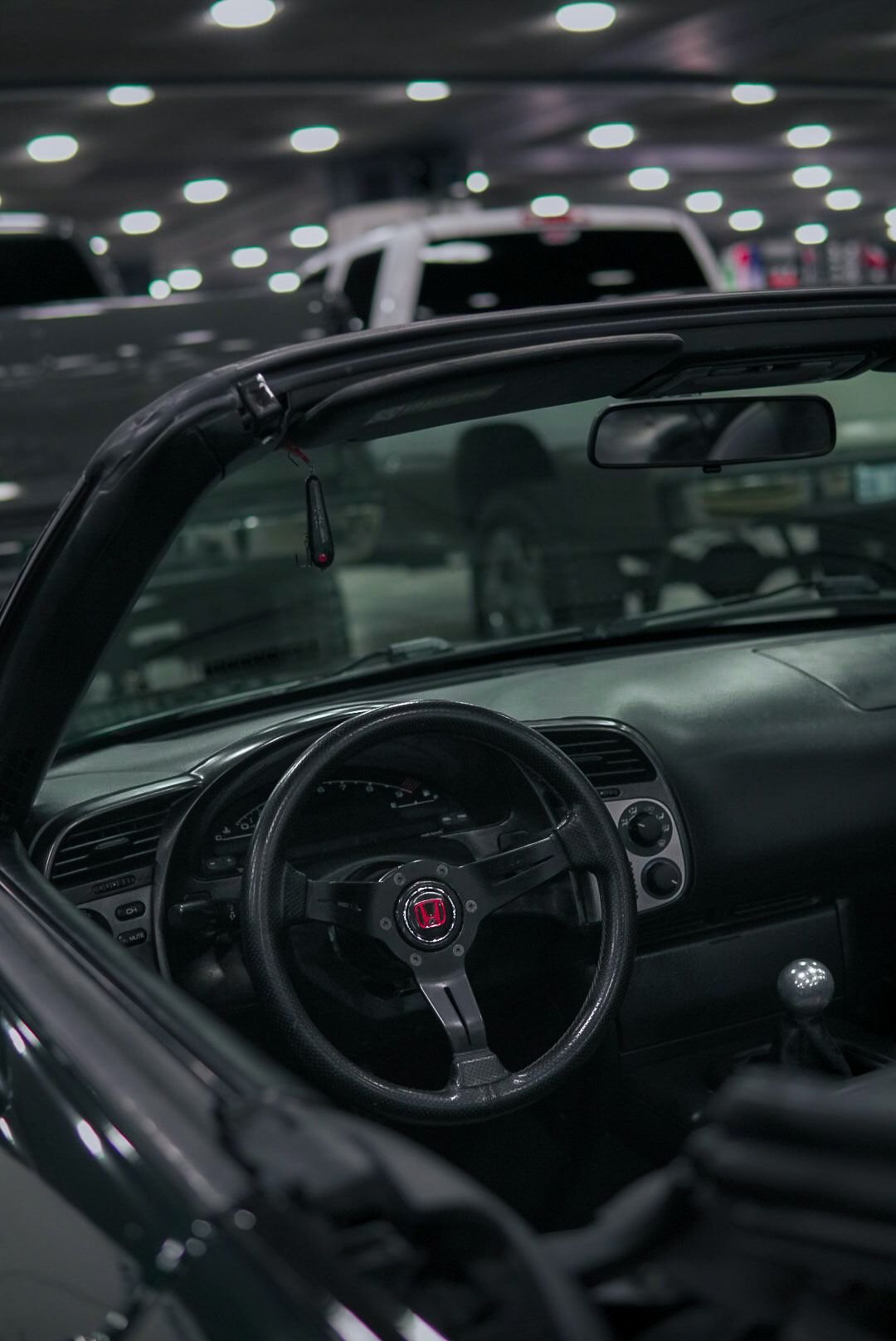

brother... give that interior a wipe down... goodness...

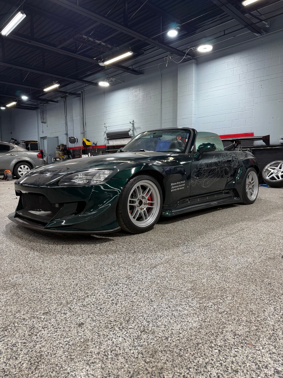

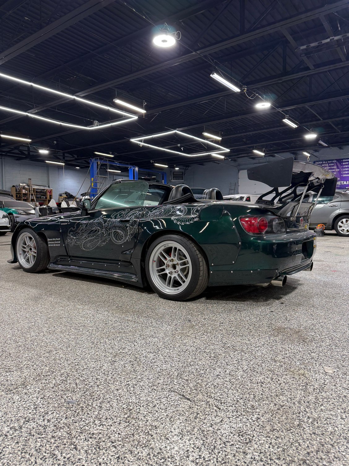

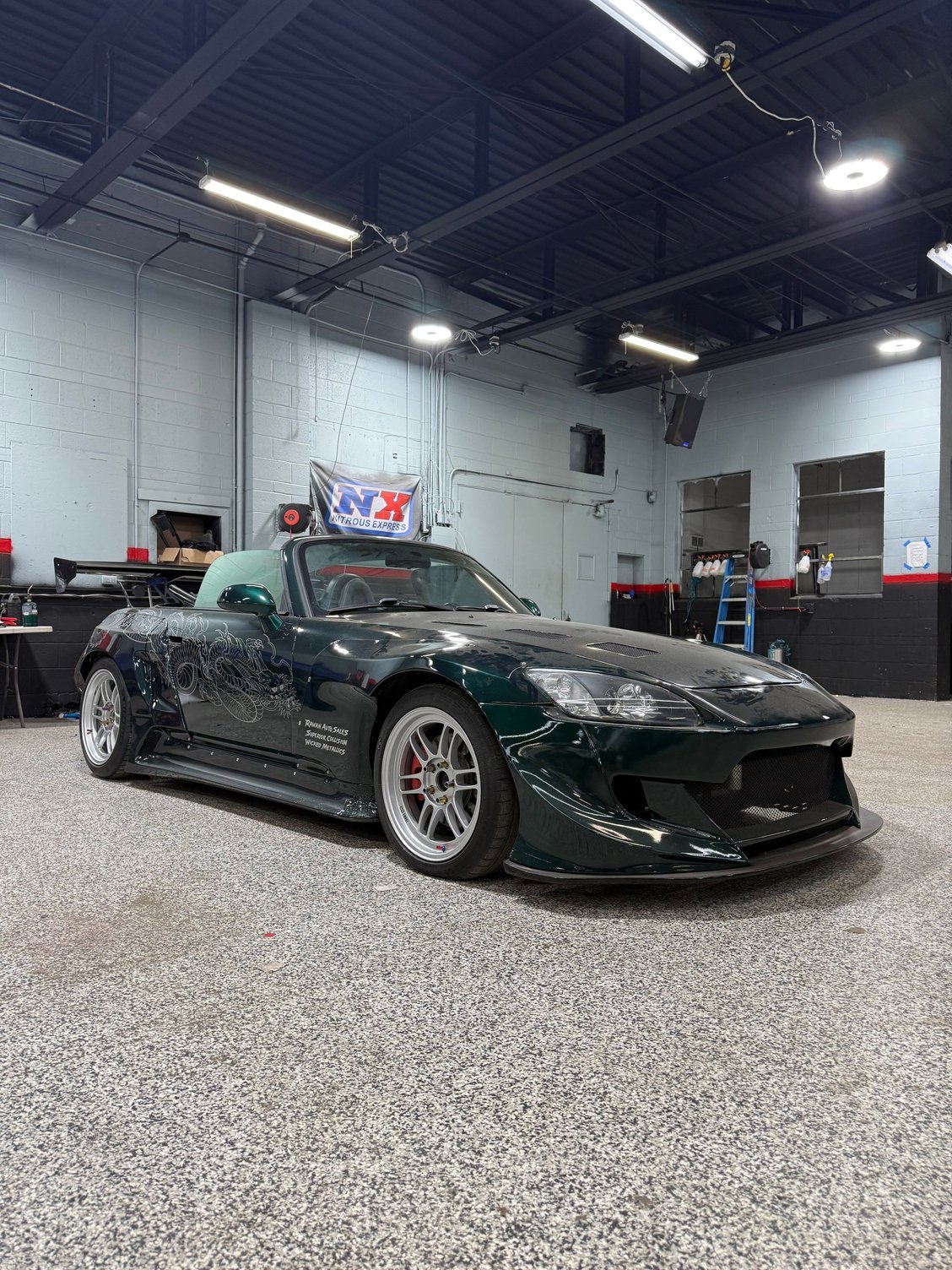

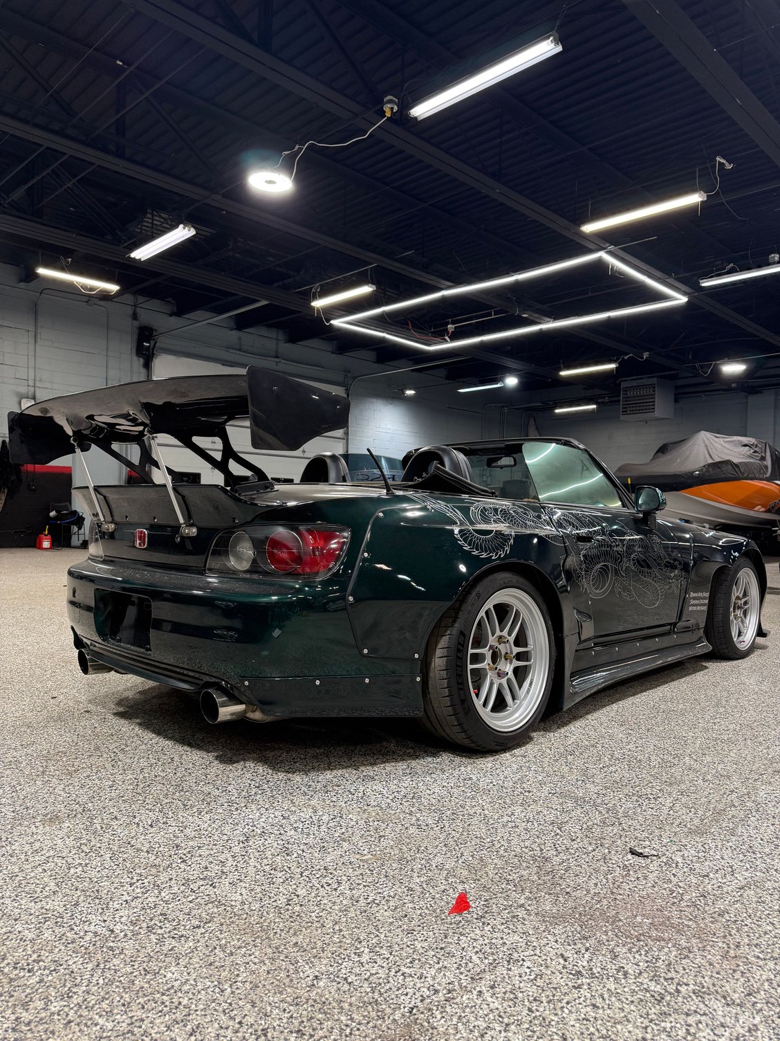

those are some older photos from right after I finished all the bodywork here are some current photos. I was lucky enough to be the only Honda S 2000 being displayed at the Detroit International auto show
