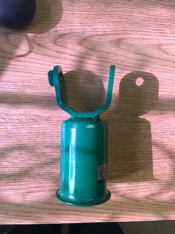

Bent the bracket. I swear, it was my friend and not me
Tein doesn't have the spare, but please tell me someone has a Flex Z rear coilover laying around that I can swoop up! This was a very expensive error.

Put it in a vice, carefully bend it back, why are you going to buy a new one? You can use a ball joint press, if you don't have a vice. Do it until you can put the bolt through. Not rocket science.

No way would I vice that back and put it on my car

You worry too much.
But...Tein will sell you a spare. They have a spare parts page. Or call their customer service.
How'd your friend bend that?

Why not? It bent the first time, steel doesn't care too much if you bend it a bit. Bending it back will not fatigue the metal, I guarantee it.
