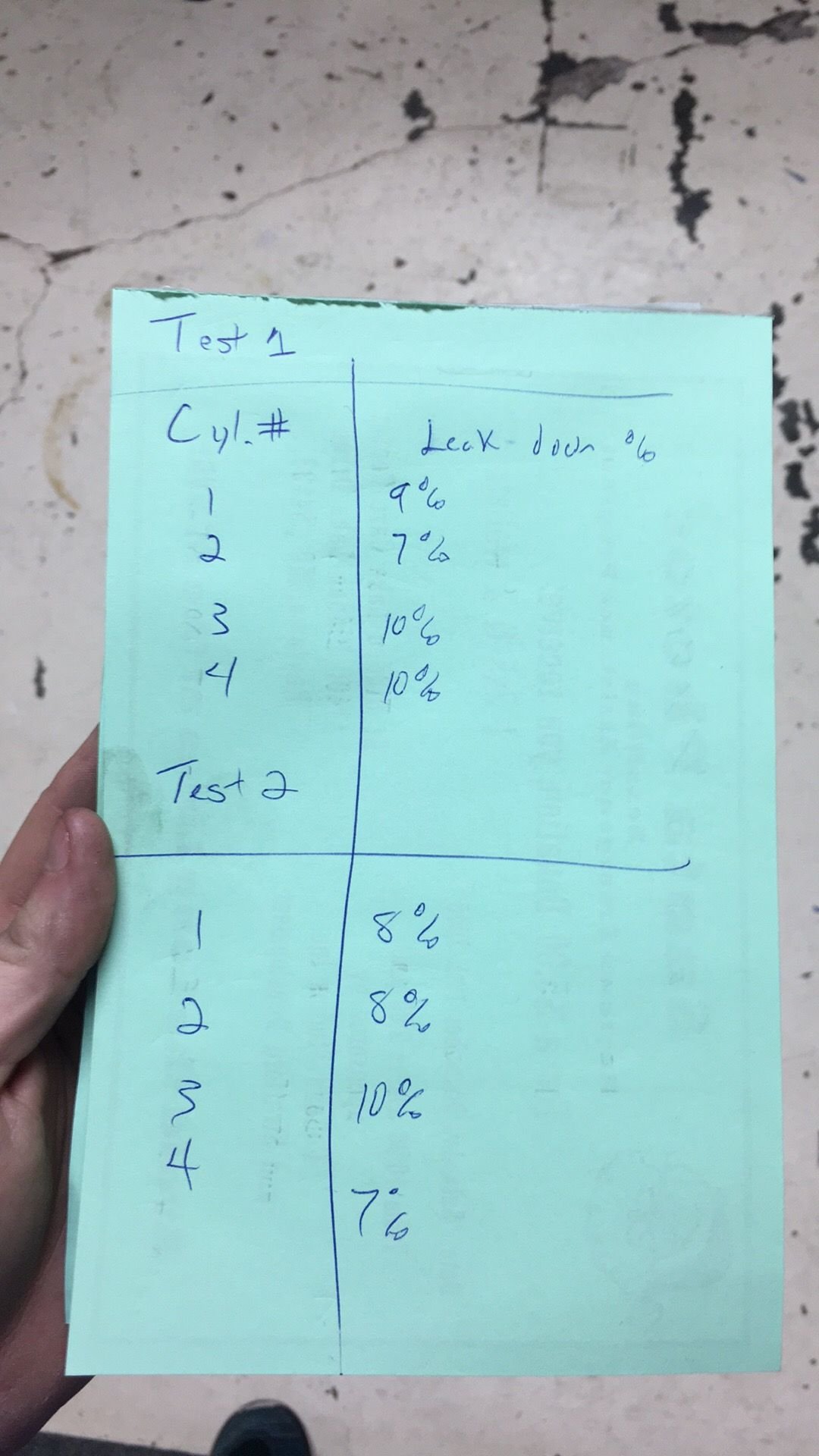

Leak down test results. Pretty damn strong in my opinion. 78k on the engine

Numbers look good. I've also seen smoke on mine after extended idling [especially when my oil is filled near the H-mark on the dipstick.]
Did you smell yours? Did it smell like something burning, or the sweet coolant described above?
What part of the country are you in (weather-wise), you sure it wasn't water vapor?

I'm in Kansas City so it is cold but it definitely smelt like oil. I tried to get it to do it again and I can't now. Drove it around a little and then let it idle for 10 minutes and revved it and nothing. Wondering if maybe the pcv could've got a little gulp of oil for some reason? Really at a loss at what it could be besides possible my intake manifold having a loose bolt which I am going to check tomorrow. The one that would be causing 4 to leak I can't really get a good turn on without taking off a coolant hose
