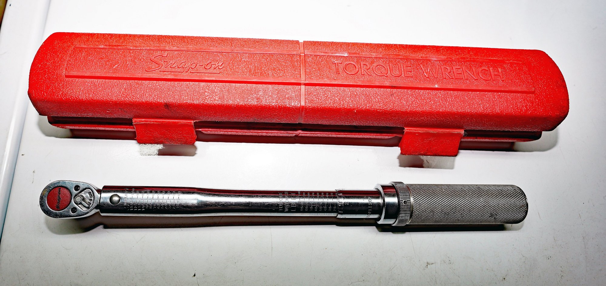

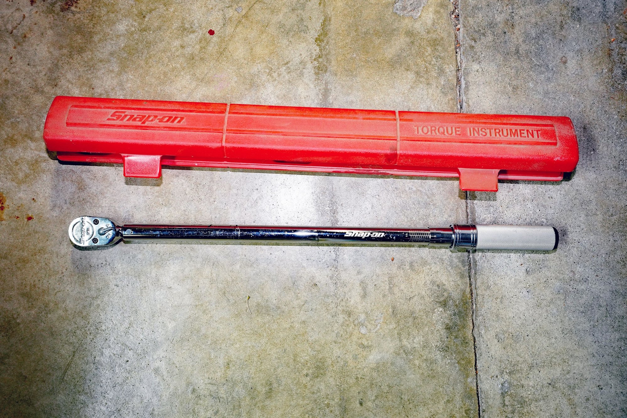

My Torque wrench is an almost new HAZET. Cames with a calibration certificate from the factory.
HAZET make great torque wrenches. Mine are old, well broken-in Snap-on.
