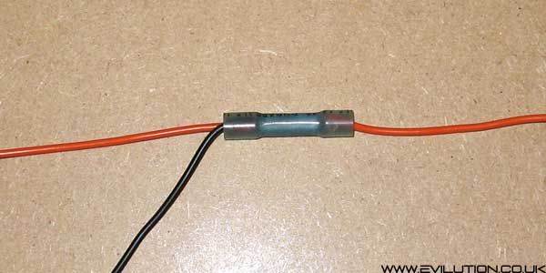

Old Apr 20, 2017 | 12:15 AM
jXxviii's Avatar
Joined: Apr 2012
Posts: 132
I don't have experience with wires, but if i twist the two together, and climp it with this, would that secure a long lasting connection? Does this require soldering? I appreciate the help guys
Old Apr 20, 2017 | 04:30 AM
flanders's Avatar
Joined: Aug 2013
Posts: 4,151
Likes: 488
From: Sweden
If you use a good quality heat shrink (the one with glue) over the crimp it might last.
But I would rather solder it and use glue lined heat shrink.
Old Apr 20, 2017 | 08:43 AM
hoobastnk90's Avatar
Joined: Apr 2017
Posts: 234
Likes: 15
I would use solder and shrink tubing. You don't want water getting into there and causing issues while your driving.
