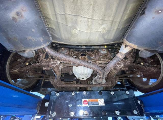

I am considering a 2006 S2000. There is significant underbody rust. How much does it cost to repair? Or should I walk away completely?
Thank you!

That's a lot of rust for an '06. I'd expect there to be som rust on the body panels as well if there's that much on the underbody. Most of that rust is cosmetic and shouldn't affect the vehicle performance, but it suggests that you might have some stubborn bolts you would have to deal with during maintenance work. It's not the rust you see that will give you fits. If the price is decent and you don't plan on keeping it for a long time, then you might consider it. It's your call.
That Helmholtz resonator on the exhaust looks like aftermarket. Mine is a round tube and that one is oval. Unless the design was changed on the AP2 that I'm unaware of, make sure that exhaust isn't aluminized carbon steel from a muffler shop.

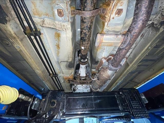

You couldn't afford to pay someone to 'fix' that rust, which seems largely limited to subframes, propshaft, and diff. Agree its mostly 'cosmetic', at least what we can see.
Also agree some bolts are gonna be frozen. Especially the compliance bushing bolt. Probably subframe bolts too.
If it were me, and car was otherwise sound, and if that were only S I could afford, I'd:
Buy a large por15 kit. Practice on a smaller piece, how to use their cleaner, metal prep, and paint.
Once I got it down, I'd go to town under there.
Then I'd tackle subframe and all suspension bolts. Try and loosen subframe bolts. If they start to bind up, go back the other way, them back out little farther than last time. Eventually you should be able to get them out. Replace with new ones, and lube them up with antiseize.
You'll probably have to cut compliance bolts out. Not uncommon issue. Not the worst thing to fix. The rest will probably be salvageable. Lube them up good before reinstall.
You'll need to lookup how to clock bushing bolts when you go to reassemble.
This is all diy-able for someone with reasonable wrench skills, determination, and not afraid to get messy.

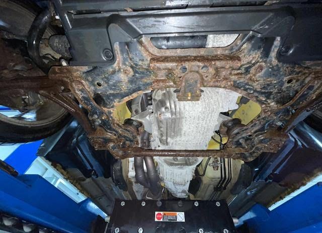

I have been underneath over 3000 S2000s at this point, I’ve only seen one that looked like that. AND I live in the Northeast. The hidden rust in the alignment ecentrics, along with many bolts, will make the car a forever money pit. I wouldn’t pay $50 for that car. Walk away.
I have also been under countless other cars in my life. The S2000 is probably the most rust resistant car I have ever seen. They did an incredible job on the unibody, only accident damage can rust the unibody. So that also says a lot about your particular car.
Parking on grass-dirt for prolonged periods will cause rust.

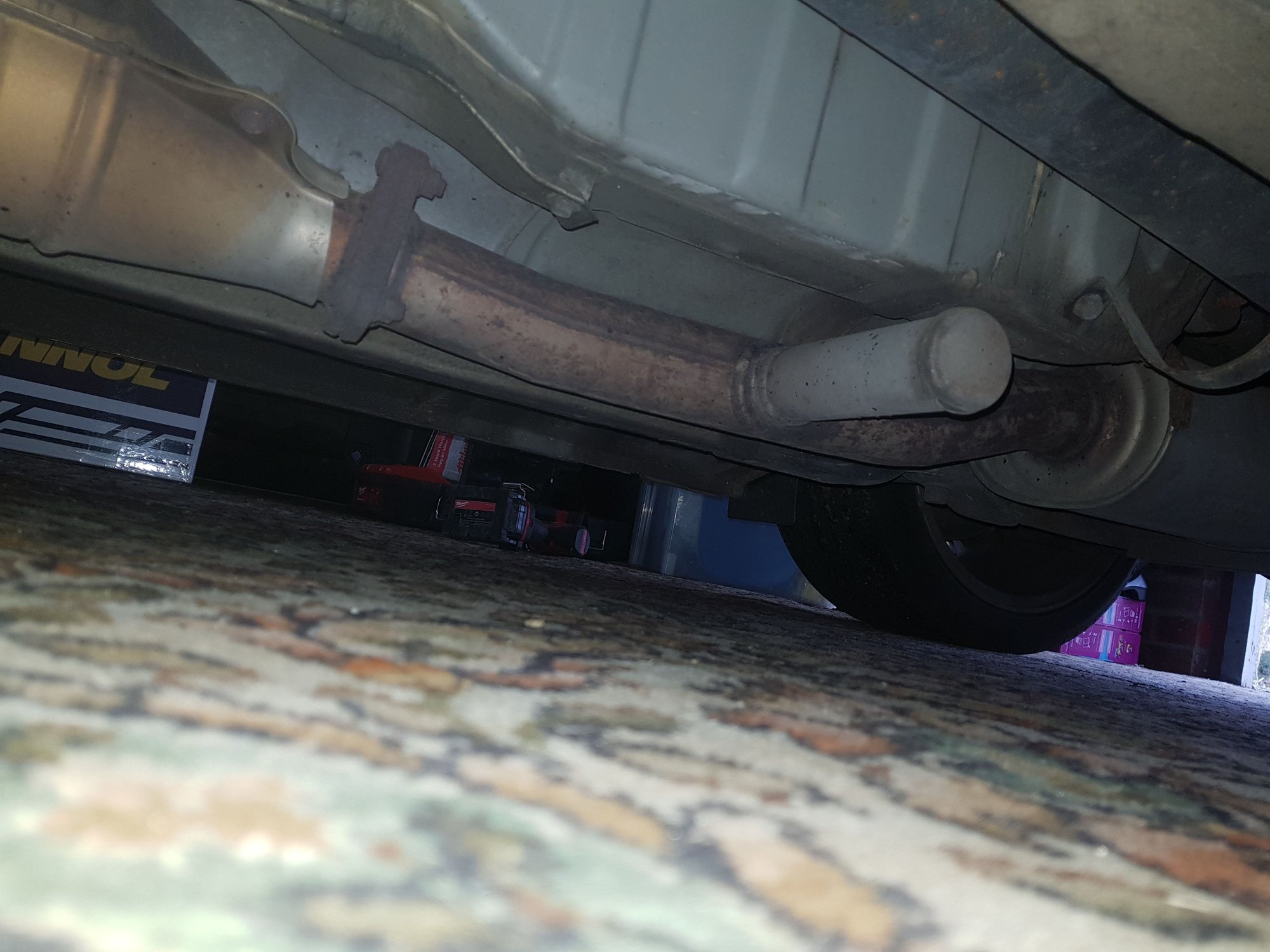

Originally Posted by Car Analogy
'06+ the resonator was indeed oval. That is the stock exhaust. No worries there.
if it is from the UK, not on my '08
also, whats happened to the little plastic tray that guards the fuel, brake lines?
