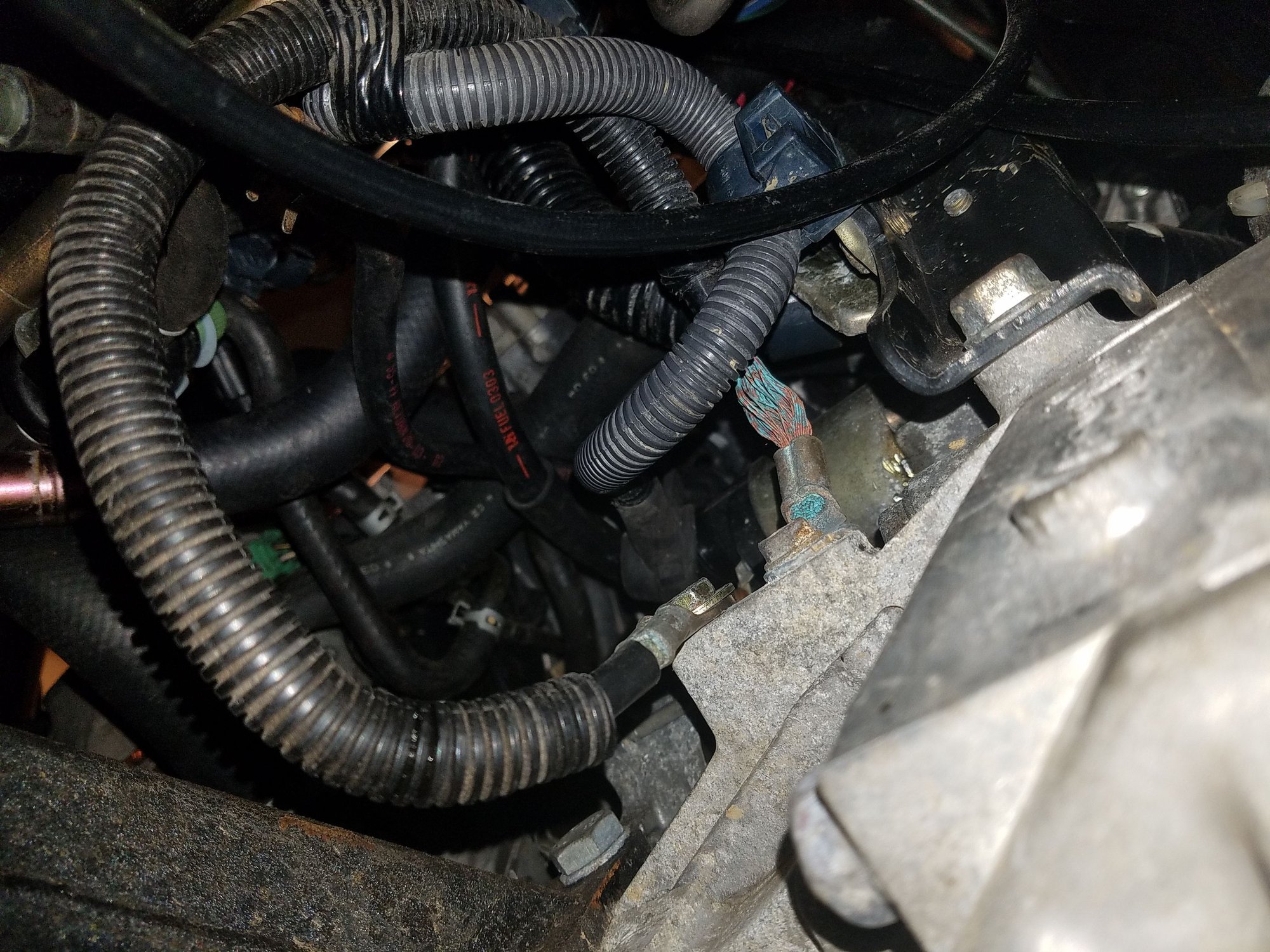

Found a missing ground.. The shorter one that is near the motor mount on the subframe. Where does it go once it's bolted to the subframe?
Old Feb 13, 2017 | 05:56 PM
mongomery1234's Avatar
Joined: Jan 2014
Posts: 1,090
Correction it goes to the right of the starter ground.. Now my only issue is I had the starter double grounded (right beside each other) where does the other end of the starter ground go?
The oxidized wire I know goes where it is my question is where does the other end go
