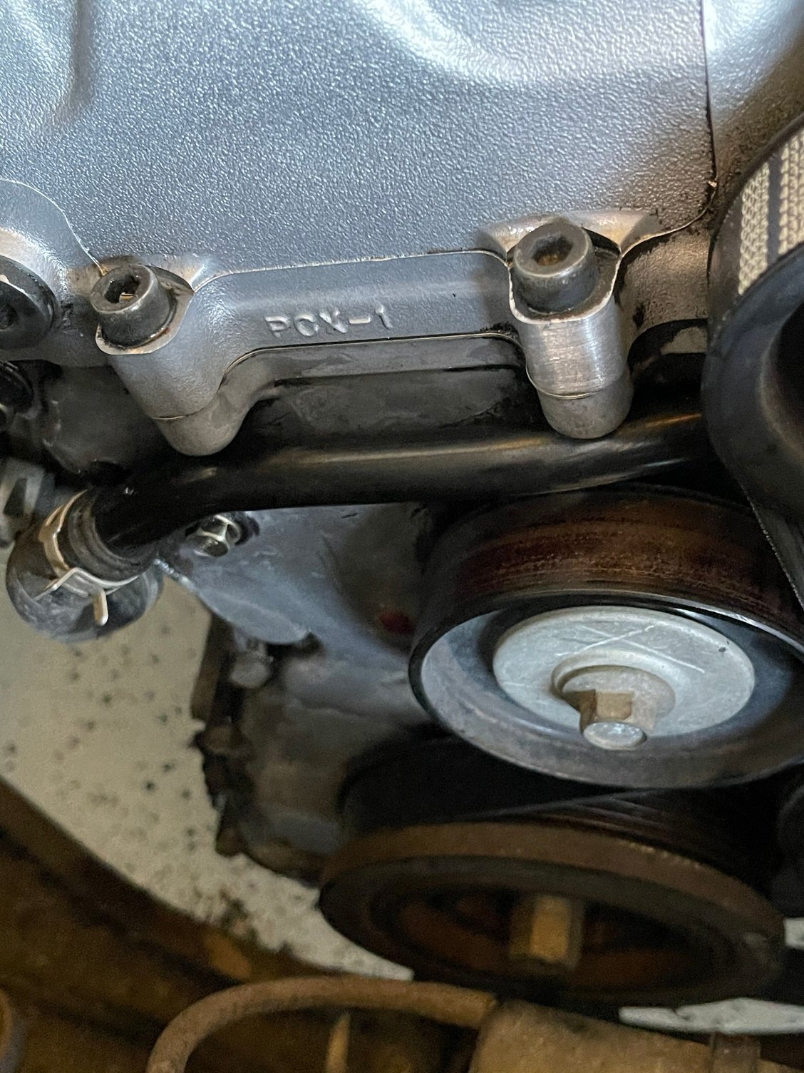

Can anyone shed some light on what this could be? Just purchased the car a few weeks ago.
Red mark and peeling ?
Higher up view

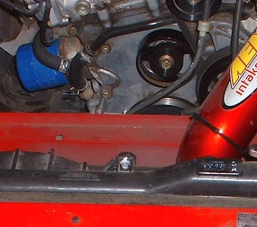

OK I think it's *a* sticker, just not *that* sticker.

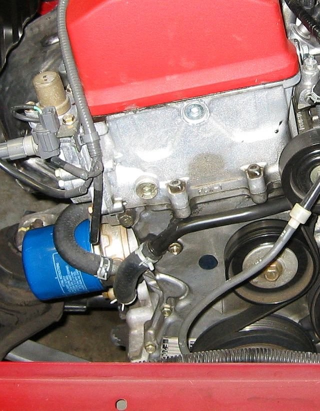

Here's a VERY old photo (2002?) of my motor, showing a dark circular sticker right where you're talking about:
And here's a SLIGHTLY more recent photo (2004?), where it's gone without a trace - obviously just cleaned off with no residue. I have no memory of this little detail, but I suspect this is the (remnants of the) thing you're seeing.

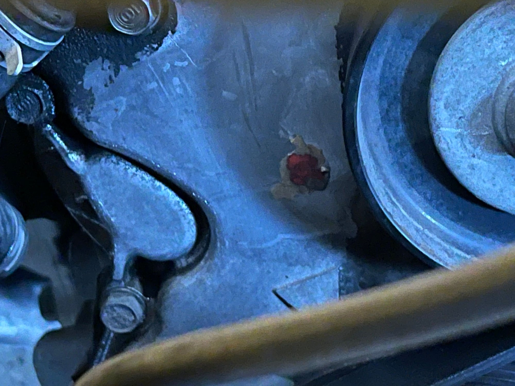

Did someone JB weld a hole in the timing cover? Would signify previous engine damage.
Take a brillo pad and scrub that spot clean, will help identify.
Old Dec 18, 2020 | 04:46 PM
Dancosenzo's Avatar
Joined: Jan 2020
Posts: 14
Scrubbed clean. It looks like it was that sticker. I thought it was some type of repair at first
