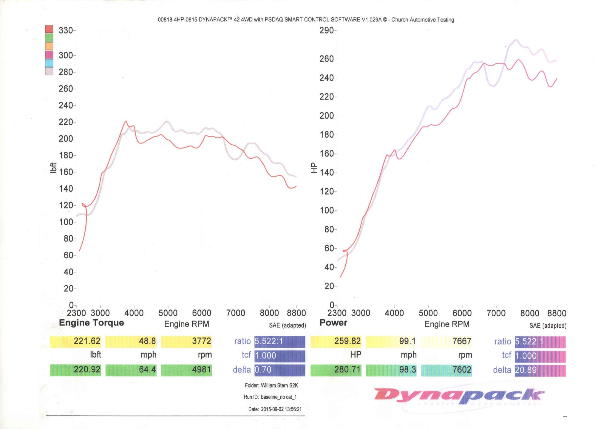

I wanted to post this earlier, but I couldn't find it. Attached, please find my dyno run. This is a Greddy Kit and no other options aside from exhaust and no cat. Dyno from Church Automotive from 2015.
