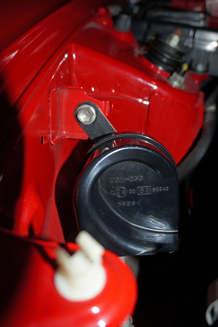

My 2007 came with this horn: UCH-253. Pretty darn loud for OEM. Loudest in work parking lot --- arming and when stupid alarm goes off, by itself.
Amazon Amazon

Do you have to remove the fender to access the stock horn? Does the hardtopguy horn replace the oem horn, or does it add on? thanks
i have a 2001 ap1.
Old Feb 9, 2022 | 06:27 PM
windhund116's Avatar
Joined: Sep 2014
Posts: 11,350
Likes: 1,794
i have a 2001 ap1.
No. It is attached to inner body panel, under the hood.
