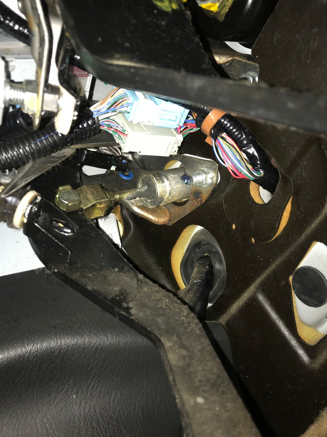

hey guys I was driving and stopped at a gas station to fill up so I turned my car off. When I went to turn it on it didn’t start the cluster came on and AC was on but the button doesn’t do anything when I press it. I read something about some kind of clutch sensor grommet that dry rots and goes bad? Any idea if mine is toast?

This video should help, it just came out today too.
A new clutch master cylinder should be on your to do list though.

...along with a schedule for regular clutch fluid maintenance. At every other oil change, siphon out all fluid from MC using a turkey baster type siphon, wipe clean to remove any contaminants, then refill. This will maintain fluid clean and fresh (it circulates as you use clutch).
That will keep it from leaking, and that nasty black dirt mountain covering the back of your MC will be a thing of the past.
