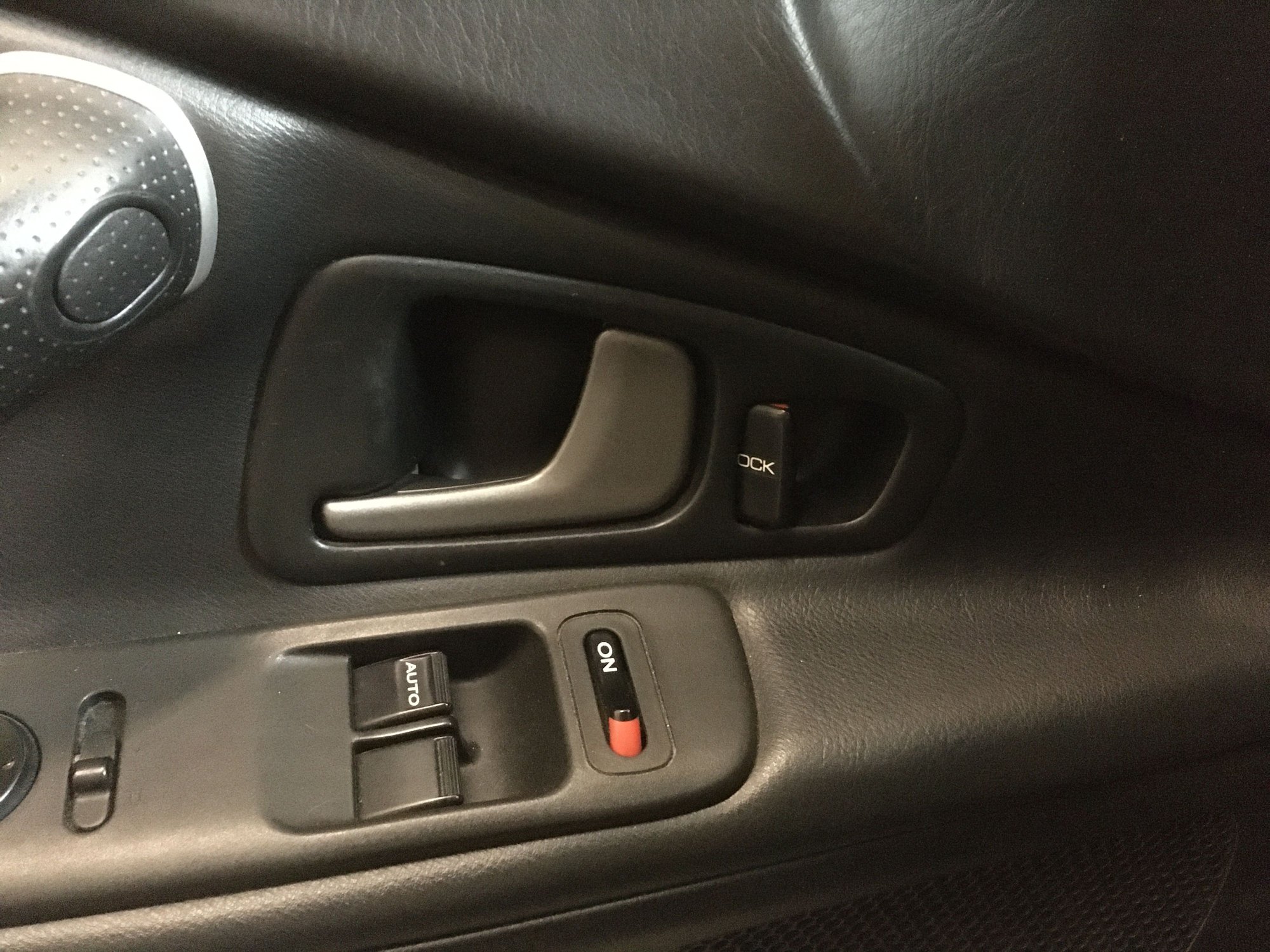

DeRosa and DaveJ, can either of you take some pictures of this button and post them?

Perhaps this is unique to 2008? Didn't work on my '06. They all have a locking latch but no "button." I tried manipulating that latch with no success. Would love to get it to work.
We need the photo but I'm betting it looks like mine.
Yup, that's what mine looks like. I tried the sequence outlined previously...didn't seem to do anything.

I tried several variations when I took the photo a few minutes ago. Nothing happens I can detect
