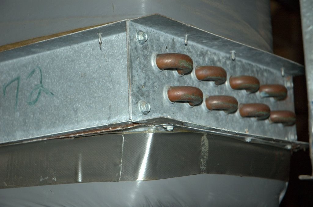

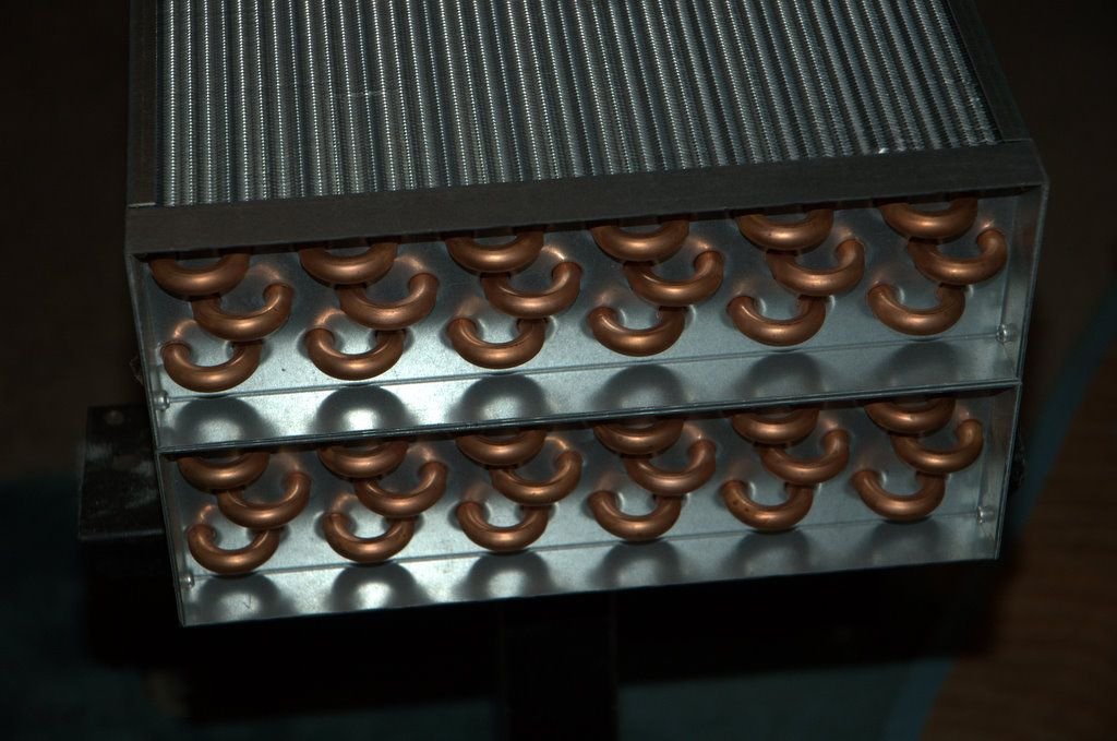

I've started the adventures in heating.
first, this is skanky old, estimated at around 50K BTU/hr.
and shiny new, closer to 240K BTU/hr.
the old exchangers is about 4" tall,
the new stack will be 7".
notice the number of coils in the old versus the new.

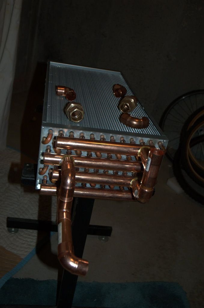

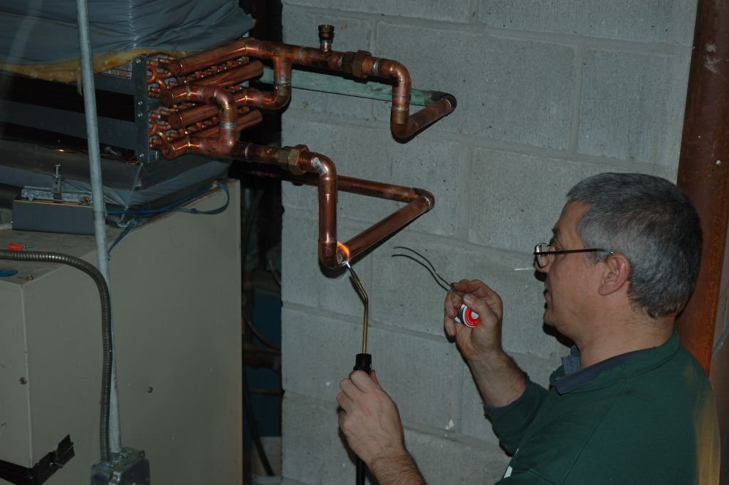

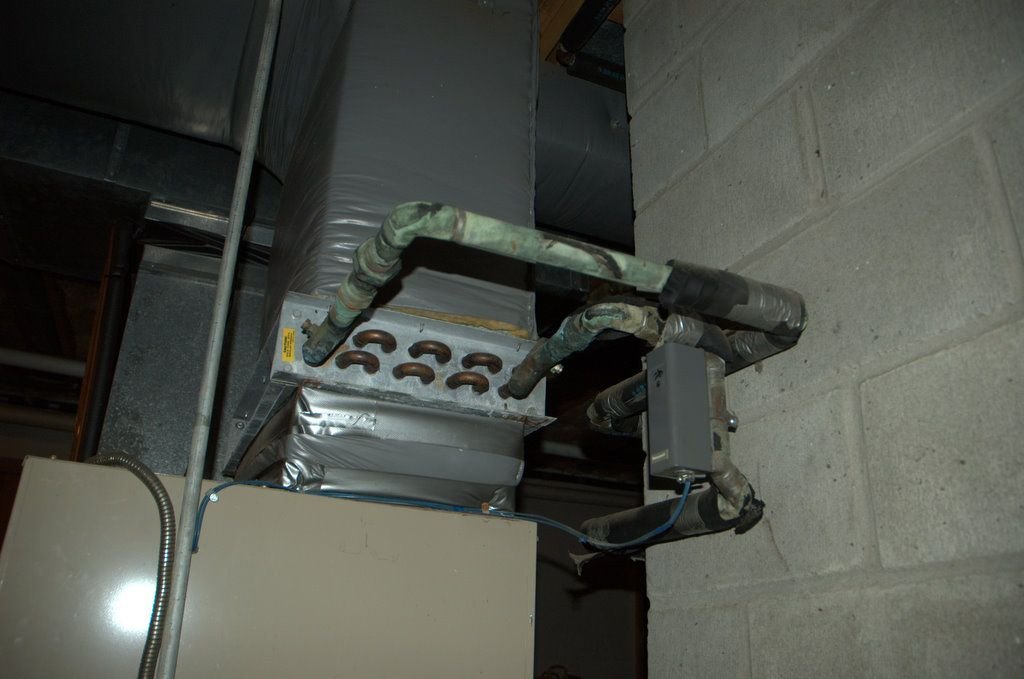

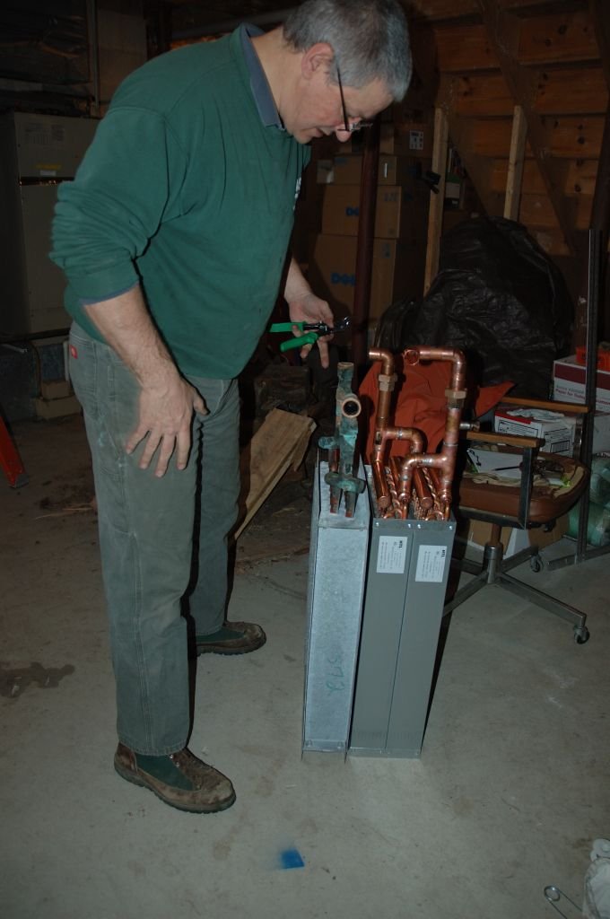

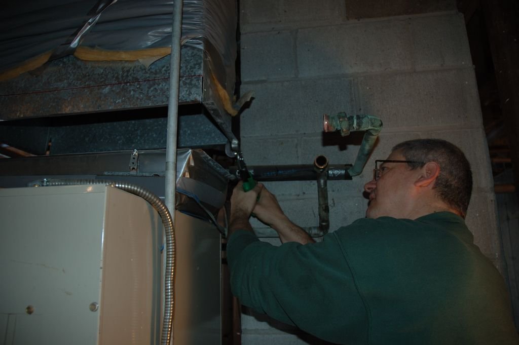

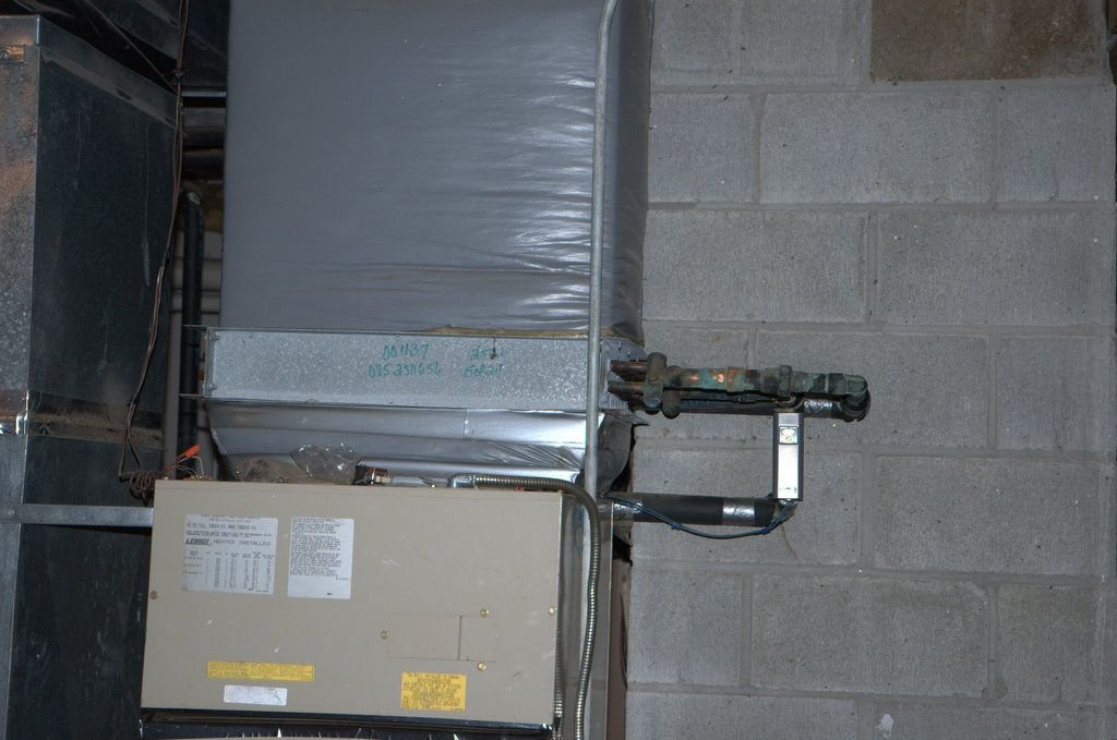

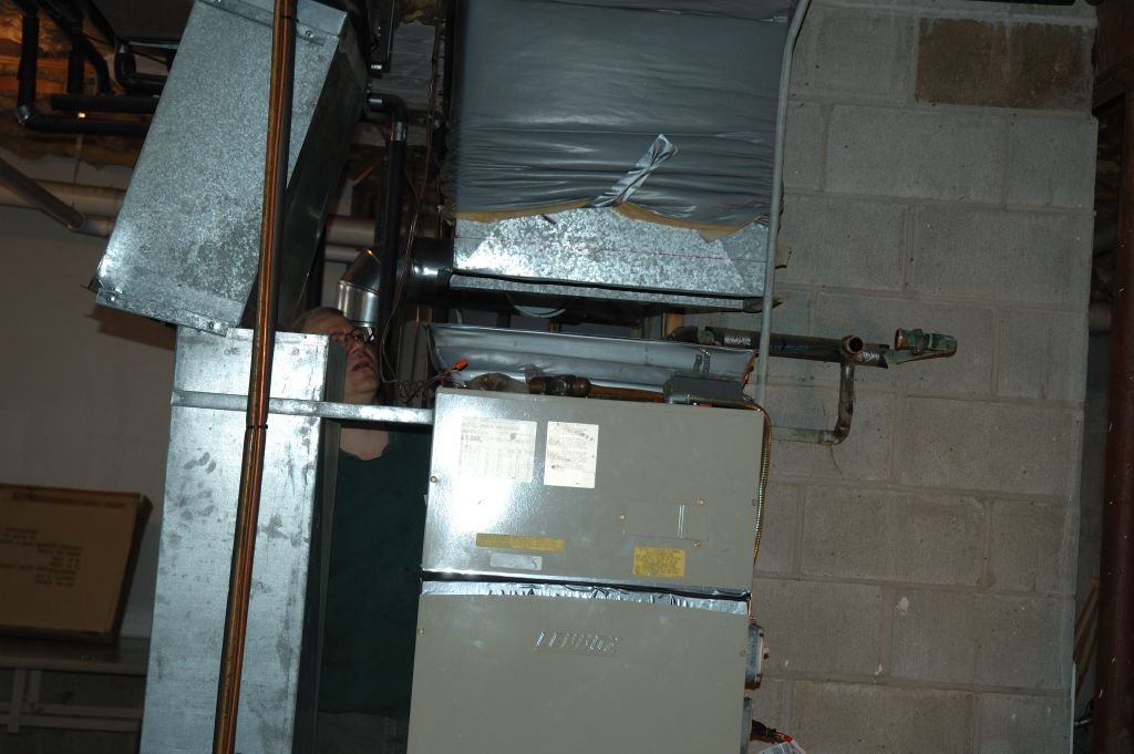

ok so my 2-4 hour project only took 2 days and 4 more trips to the hardware store.
all in all a successful venture
the point of no return
a little nip here and a tuck there...
the best part about sheet metal work is unlike those pesky paper cuts, sheet metal just rips the flesh out of the way.
skanky old vs shiny new
presto it's installed
a little solder here
some more solder up here
27 solder joints, AND NO LEAKS on the first try.
and yeah we have heat again...
of course a smarter person might have done
it in the summer or fall when heat wasn't necessary.
It appears that it was worth it though.
the exhaust temp coming out of the old system barely broke 100°F, the system now has a vent temperature of 148°F.
