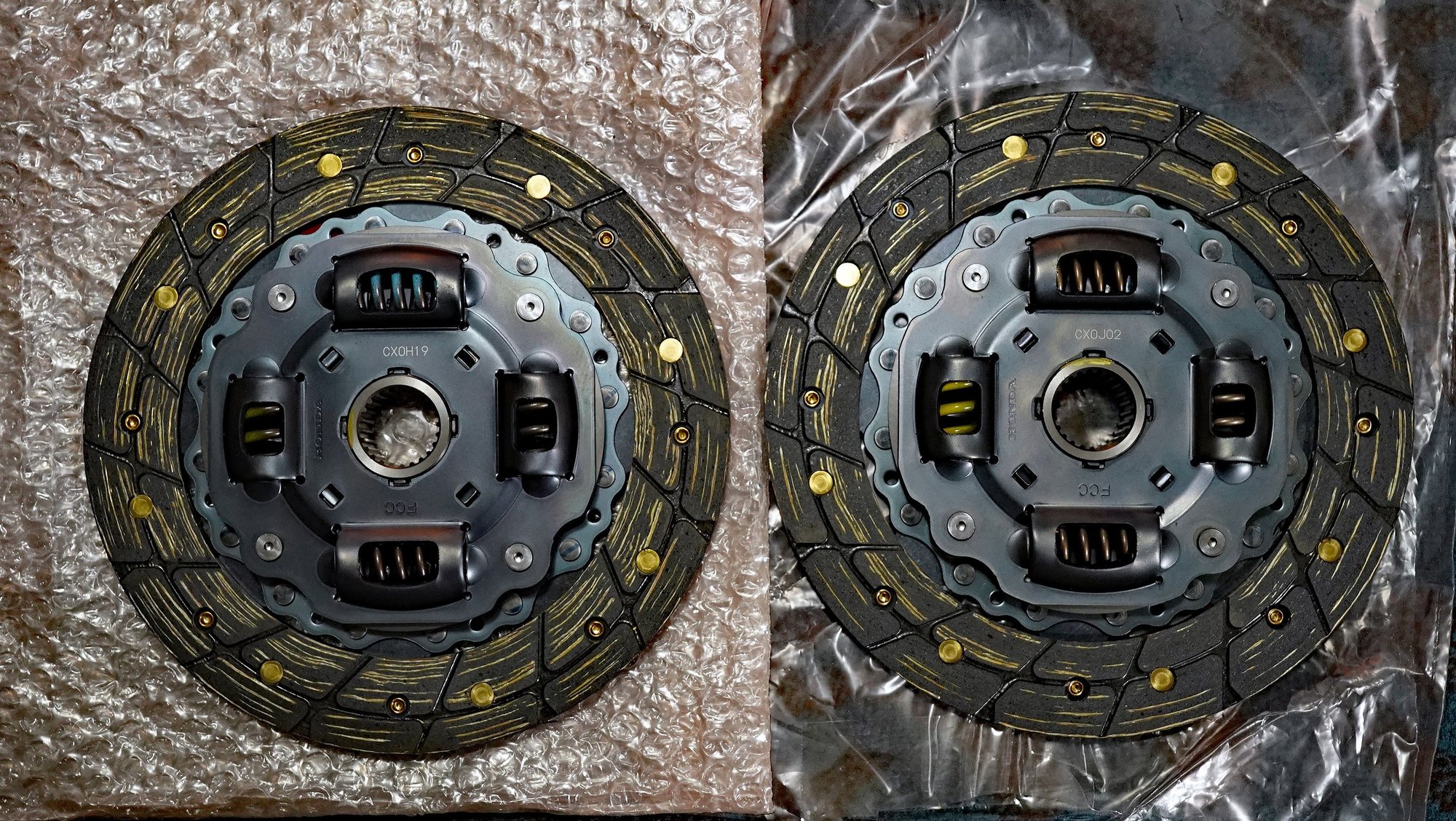

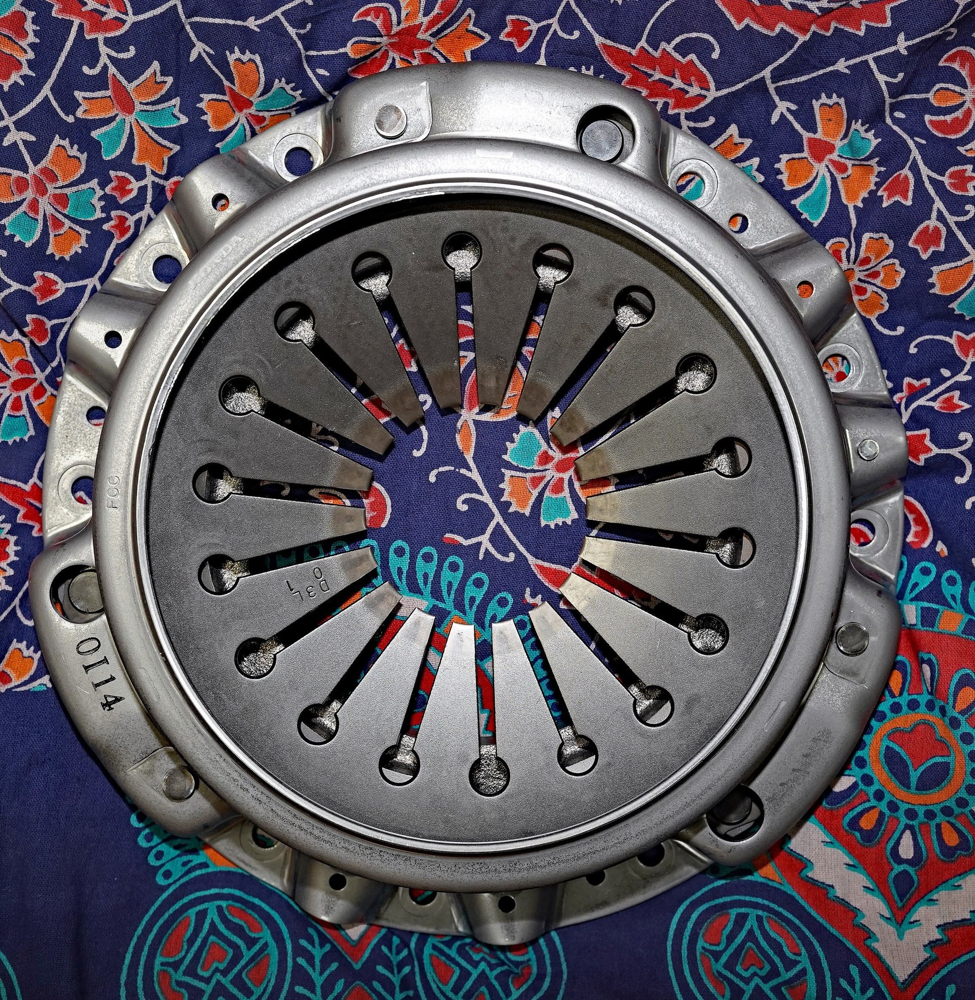

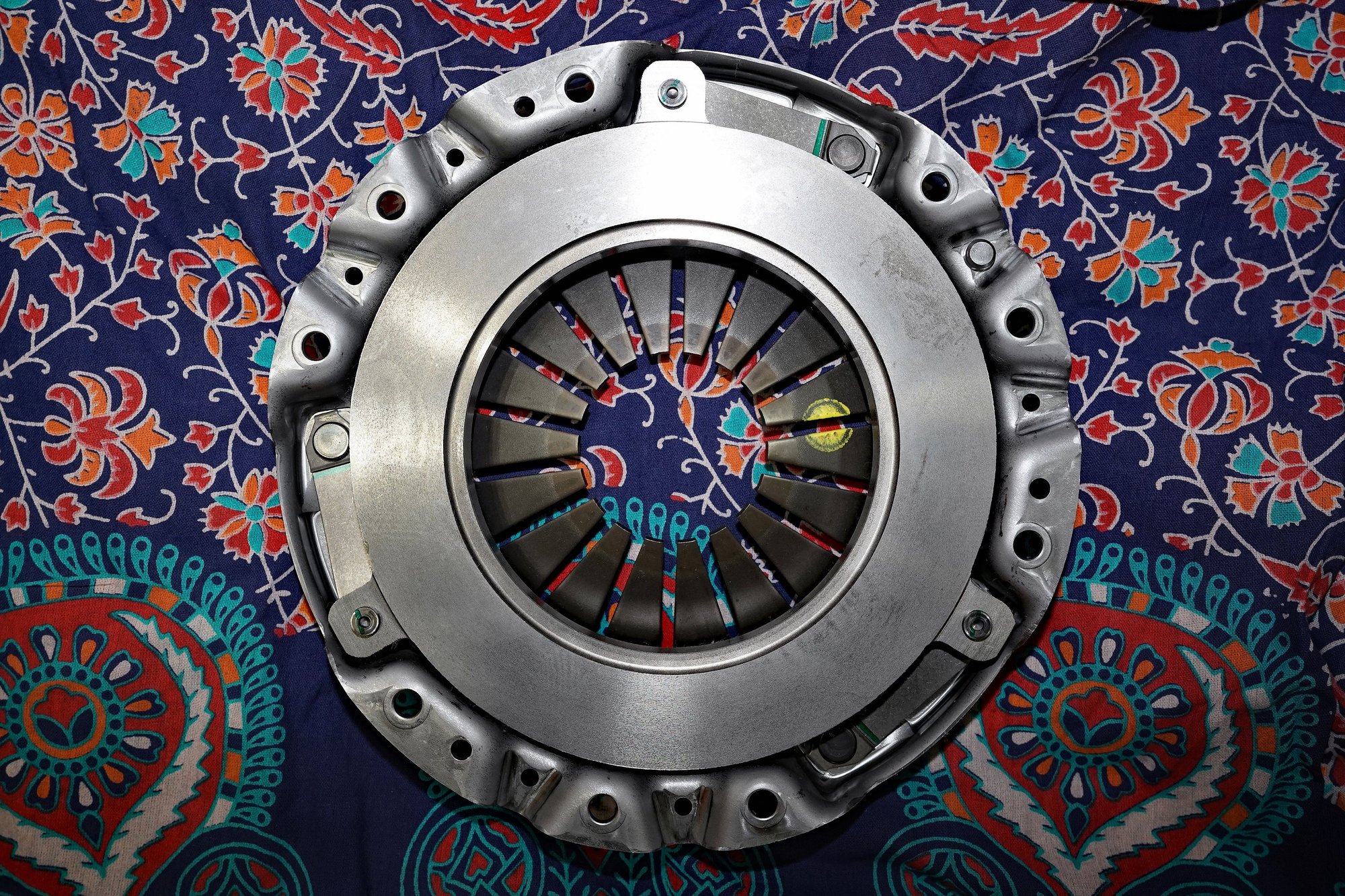

I had my clutch disc and pressure replaced in 2021. Finding a mechanic that knows how to work on S2000, is important. Uses of high-temp Honda lubricant is also important. I bought my parts off eBay, for quite a bit less than dealer prices. Photos of the parts I bought.
The feel of the clutch action has been sliky smooth. Never was this good, with the original unit. Took the mechanic 6 hours to do the complete job.
Disc from Honda dealer on left. Disc I bought off eBay on right.
