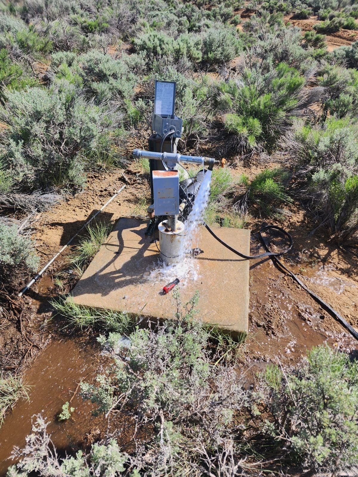

I know some of you (Jerry) have wells and I'm trying to get an education and some insight with the problems I have with the well and generator I have up at Kennedy Meadows, CA. I have a 5th wheel there and a Kubota generator along with a huge water storage tank and the well. Here's the summary of what I'm got going on and my question about what to do next. The generator was installed in October of 1992. I'm not sure about the well pump.
(1) 4-14-2023. The well head water pump won't turn on.
(2) 5-21-2023. Philip Berry, well guy, came up and got the well pump working on his generator. All he did was replace a fuse. It wasn't a new fuse since he didn't have one. He texted me a video of it pumping water. ($500)
(3) 6-29-2023. I went up and turned the generator on and then the well head pump and started filling the big water storage tank. I walked back down to the trailer with it all working.
(4) 6-29-2023. I walked back from the 5th wheel to the generator to turn off the well head pump and the generator, but nothing was on. I kept trying to start the generator and it did start but shut off within 7 seconds.
(5) 8-26-2023. I met Jim John's at the generator and he worked on it, changing the oil, filters and petcock. ($350) He couldn't get it to stay running. He suspects the voltage regulator is bad. He has offered to get a new one to put it.
(6) 9-19-2023. I could go for the new voltage regulator but now am wondering if it will just get blown/fried. If there's a problem with the well head pump that should be handled first.

^4-14-2023. Well head.

I had the local well guy out. He was the one who got the well pump running in May. All he did is change a fuse. He's the one who took the photo of the water running out.

I would want the pump motor megged out to see if the windings are failing. I would also check the amp draw on the pump compared to the nameplate info. With a fuse failing it sounds to me that the pump is dying and may need to be replaced or rebuilt. Hopefully your pump man put the correct fuse back in. I would not be concerned with it being an old fuse as much as it being the correct (amps, time delay or not) fuse.
If the pump shorted out it may have taken the generator voltage regulator with it. It definitely sounds as if the pump started the problems.
