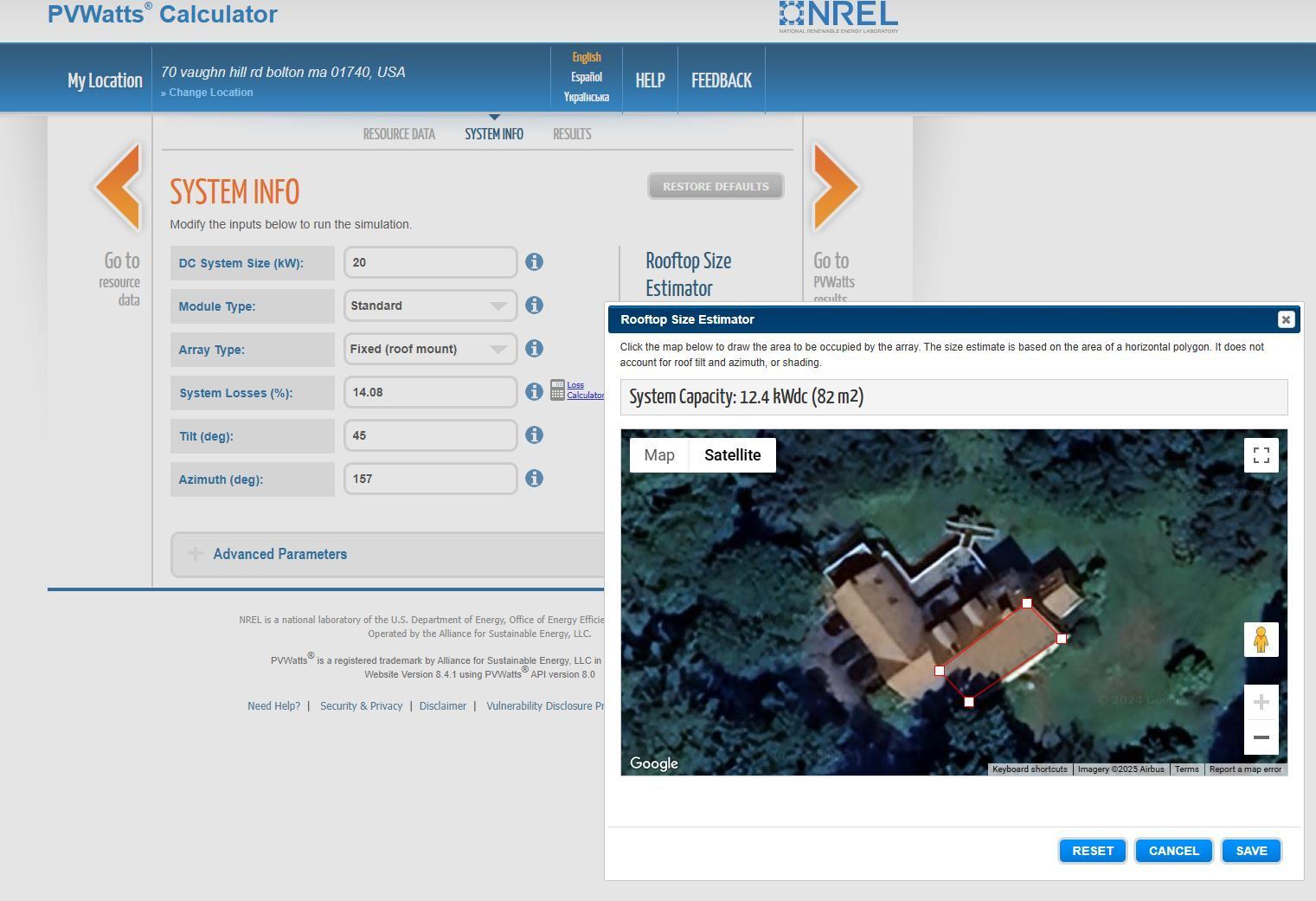

As for the general rules of direction yield, shade, etc. I'm an engineer, we don't guess. We model.
https://pvwatts.nrel.gov/ this is a handy little model. You can pull up your house from the satellite shots and frame where the panels will go.
It also accepts the roof slope and true array solar direction.
It will then calculate using historical weather data how much power you can get pre year and per month.
It looks like this
It not perfect but it gives a much better swag at it than back of the envelope chicken scratches.

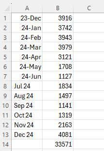

not dumb at all. I have data !!! I actually have data down to which circuits are using what.
yes that's kwh
I also know how much roof I have, what I can put there and how much power it can produce.
It turns out my daily demand is for the most part higher than what produce.
at noon I don't use it all up but will later. I then have a choice, sell it back to the grid or charge a battery.
The battery has an upside is it also provides ride-though for power outages.
But batteries ain't cheap. so it becomes a how long do I want to be able to go.
