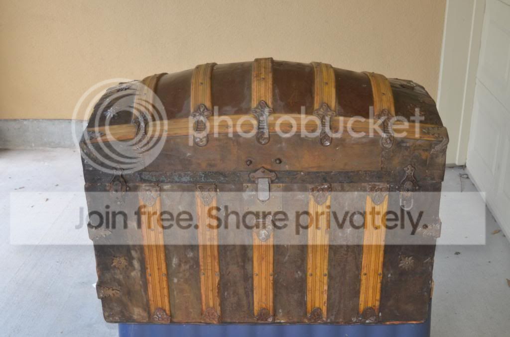

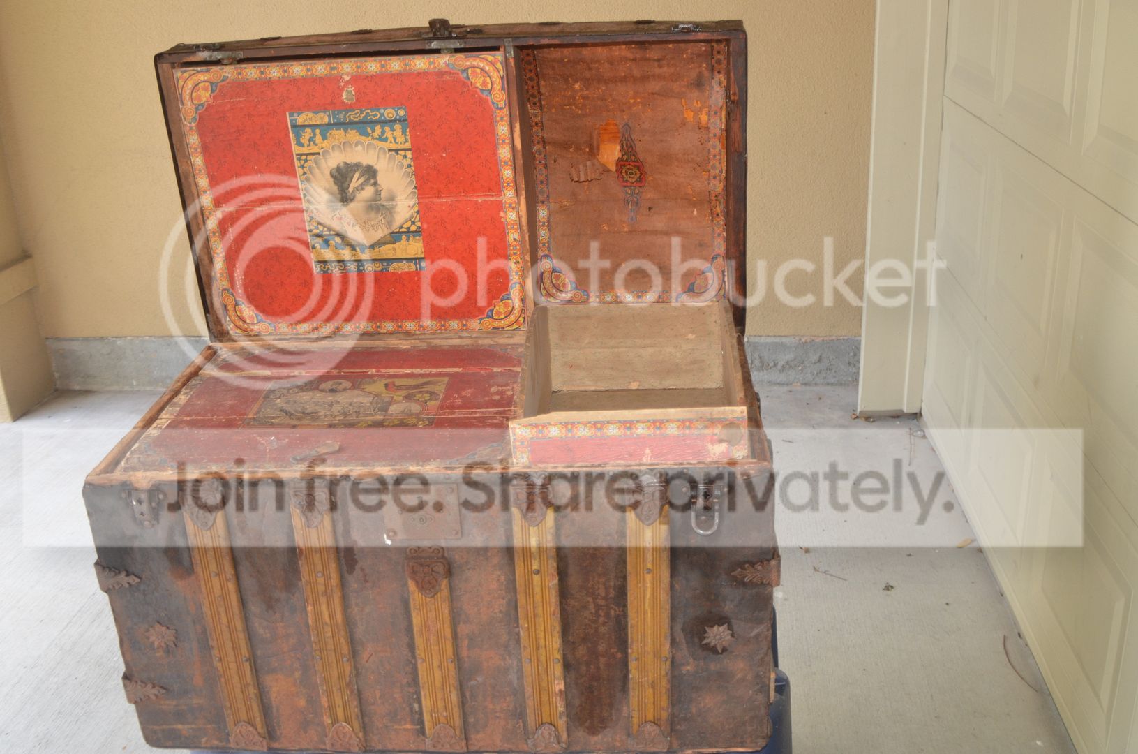

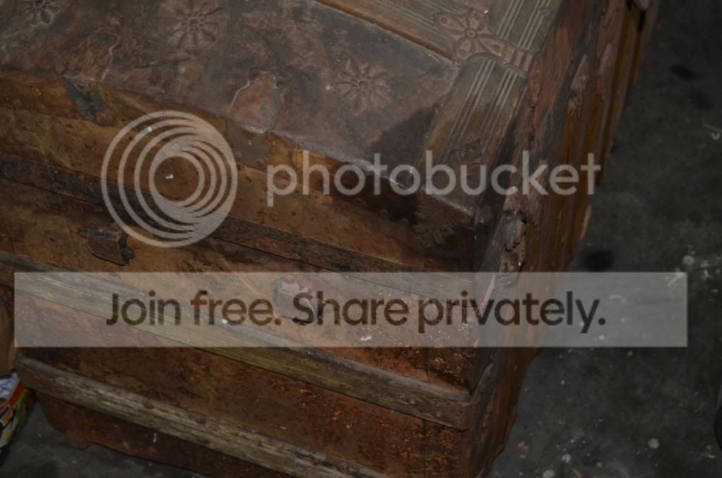

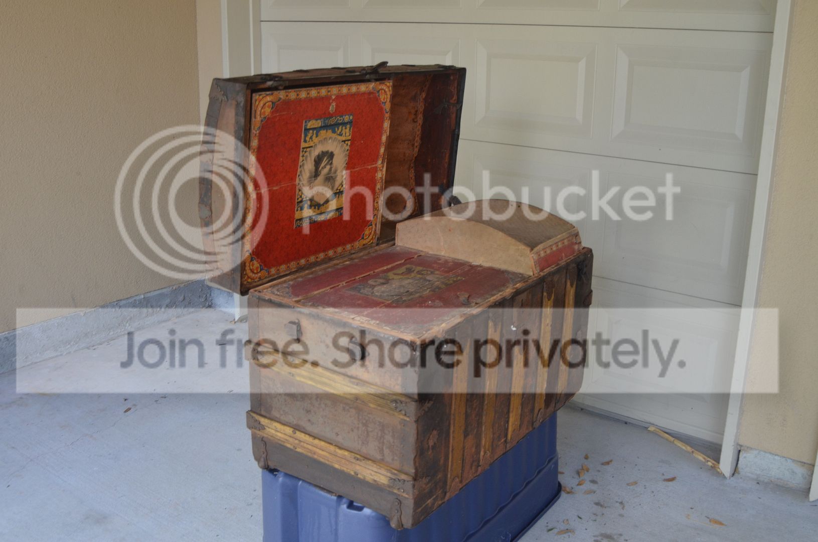

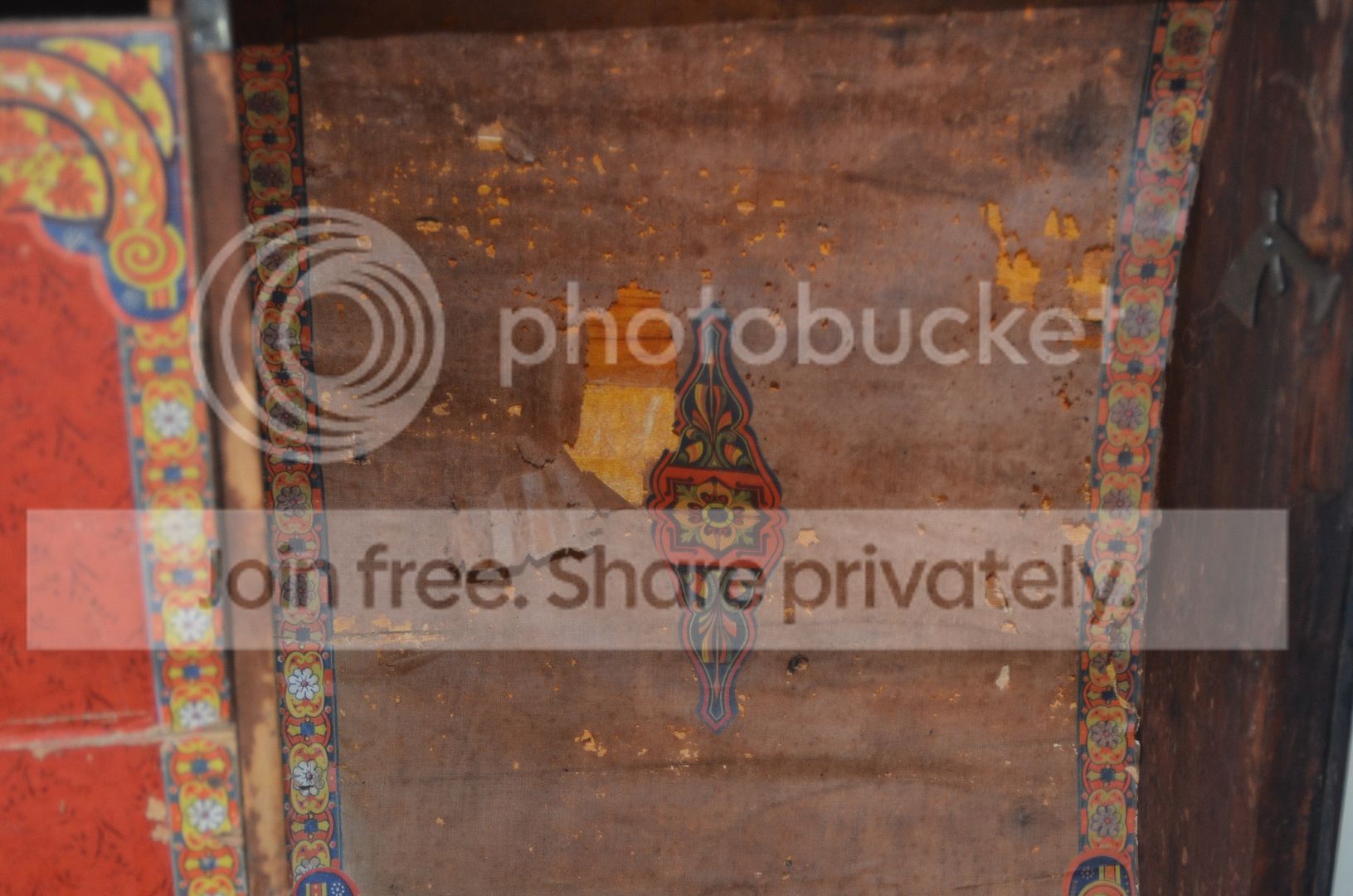

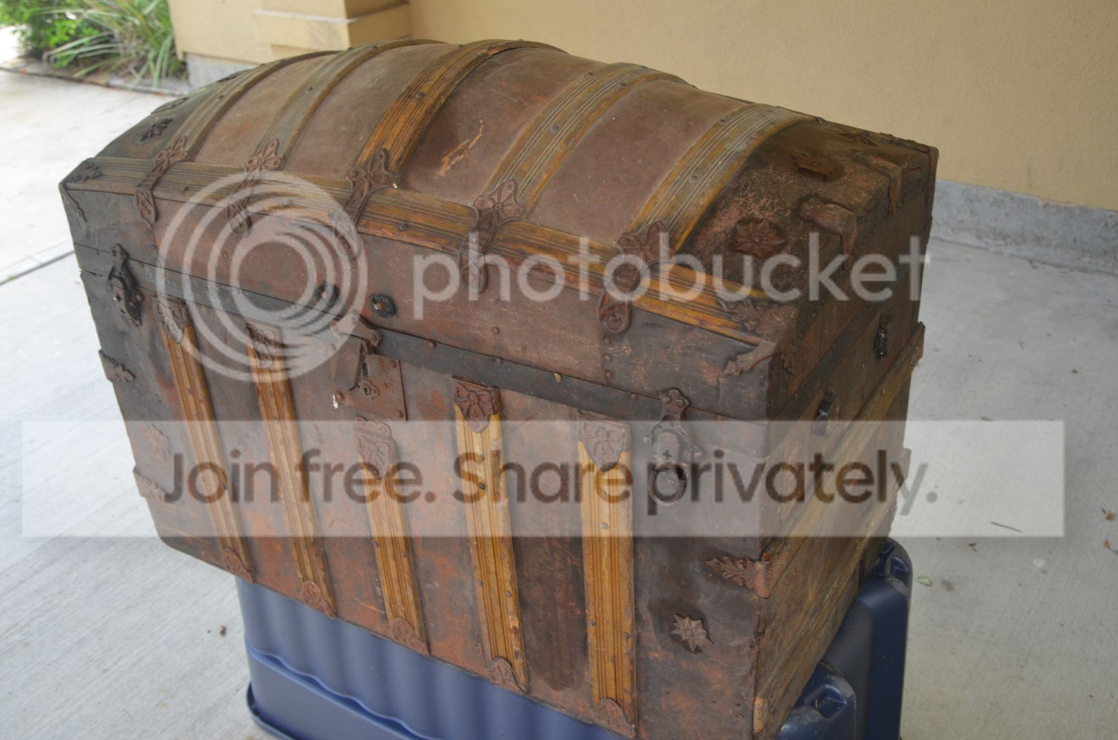

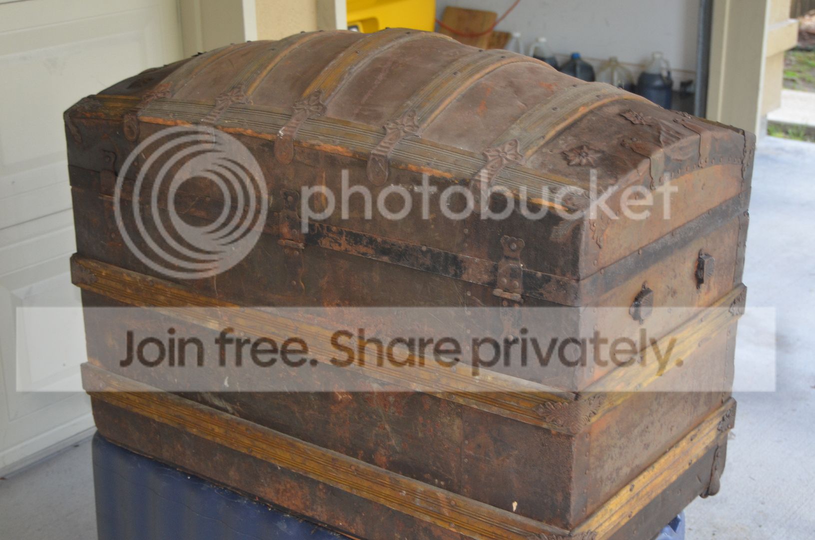

I have had this old, unrestored, 1880s style dome topped trunk that I bought in Pennsylvania in about 1980, but now I want to do something with it. I haven't found anyone good to restore it, so I am going to refurbish it myself, leaving it as original as possible. I am looking for some advice on what to do. It's in pretty bad shape. I have begun to remove and treat the rust on the metal parts. I got rid of most of the musty smell by storing old crumpled newspapers in it for a while.
I know that Legal Bill restored a similar one some years ago, but I only saw it briefly, so I don't remember what he did with his.
Any suggestions?
BEFORE
Front
End.
Back
Open
Lithographs
Whatever I do with it, I'll post some AFTER pics.

I would try to get an estimate of the cost of having someone else to it. It might be too labor intensive to do it yourself. or make a friend of someone who works with wood and antiques. You have a great smile and nice demeanor ... the worse they can tell you is no.

Yeah, I think the high-end curved top trunks first appeared in the US about Jenny Lind's time. The style even came to be called the Jenny Lind. Then there was the domed Saratoga (=The Spa that the well-to-do took their Jenny Linds to.) I didn't know about the gender thing. The lithographs are clearly feminine for the period. And the camel back holds more stuff!
I have been brushing and cleaning it this afternoon. I thinnk I am going to enjoy doing it. If I could find a good professional restorer I would definitely use them. I would like to have it as close to being original with patina as possible. I ordered some parts for it today; leather handles and such. But I am keeping the original hardware - just steel wooling it. As a final coat I am thinking that tung oil can be brushed on all of the surfaces, inside and out, after proper preparation. Apparently the end sections of the trunk were painted black, but I can't really tell what color the interior sections were.

It's a real cool piece Jim. Enjoy the project. Looking forward to the "after" pics.

You have all the interior dividers. That is rare. Mine does not have its dividers. I first cleaned the outside of mine with soap and water to try to find the original paint colors. I found black and brick shade of red, much like yours, Jim. I used steel wool and a wire brush and cleaned the metal of all the rust, but not going so far as to lose the stamped detail. I painted it with Rustoleum. I painted the decorative hardware with a gold paint of now unknown origin to look like brass. I still have the original handles. Mine still looks great after about 25 years. Tung oil on the wood is a good idea, but not too many coats

That is a really nice trunk. Definitely worth restoring!
