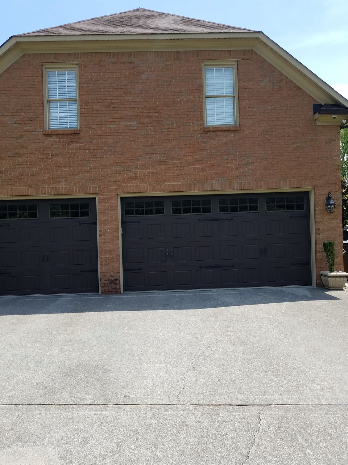

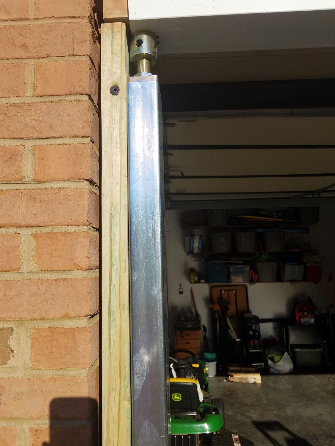

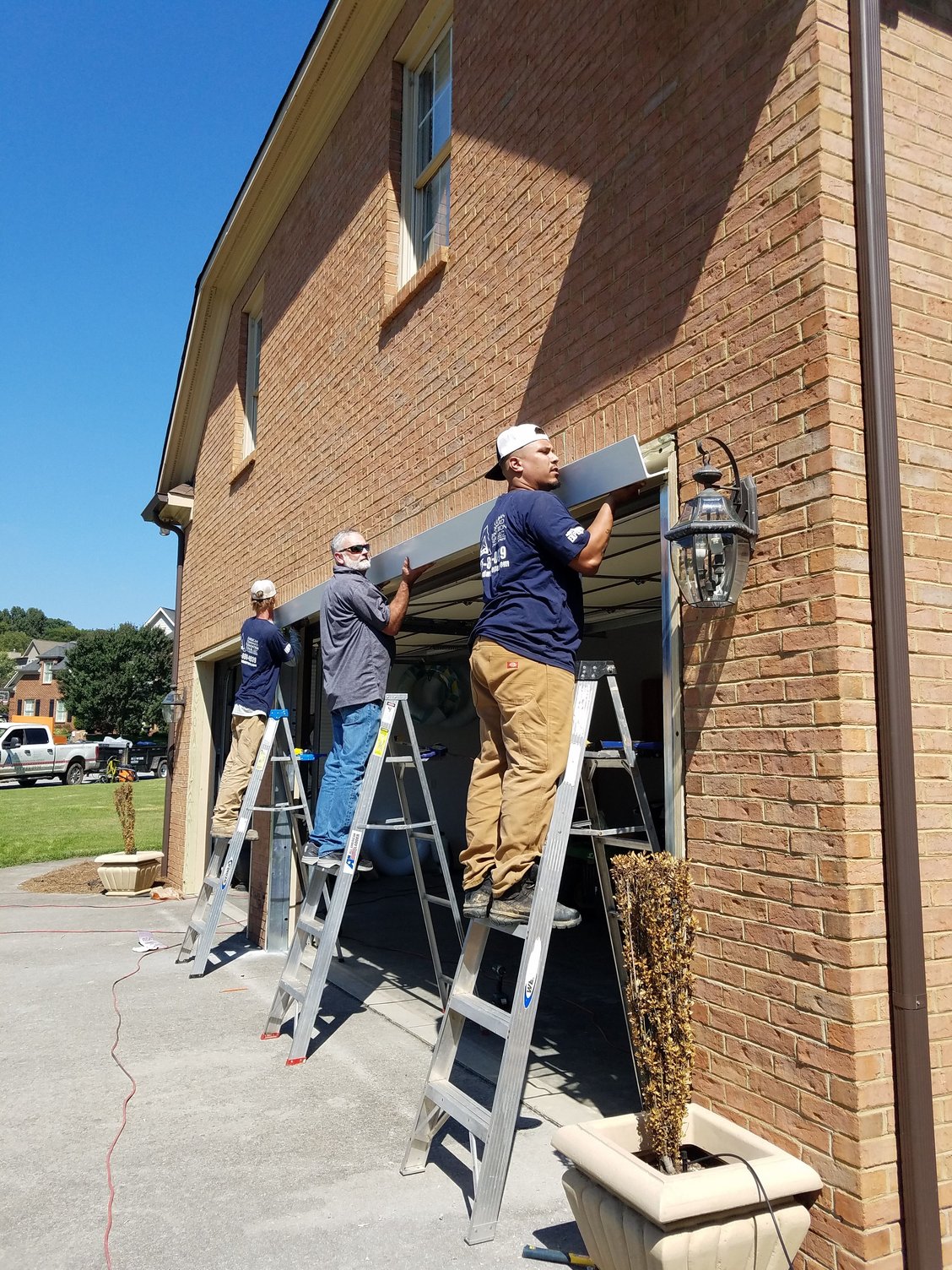

Had a bit of a problem with cracked mortar joints and a "saging" lintel above the 16ft double car garage door at our daughters home in Knoxville. I believe it was a design/builder flaw when the house was built in 2004. Found a company on line that developed the "Lintel Lift" solution out of Birmingham. A local installation company took on the 10.5 hour project (it was their first install under the direction of Greg from Lintel Lift.) Check out

Yep .... an "I" been would have been great. However, the builder decided to use 2 each 8 ft angle lintels butted together and I can only assume they were bolted to the wooden header that holds up the wood frame of the house and that was probably underbuilt . Odd thing is that every 2 car garage in the developement whether siding, 59 courses of brick or 2 courses of brick above the garage door use the same 2 lintels 8 foot long.

I assume there are many building defects in that region to support a company that just does lintel lifts. We don't get much of that in our parts as our building standards are pretty strict, glad to hear it got fixed correctly. Good work.

I would love to have that much garage space, sag or no sag. But the inevitable cracks in the brick work would annoy me. Nice job. Hope it holds up. That L beam looks pretty stout but that is a lot of downward force at the center, although I would think the masonry would help distribute forces away from the center, at least a little.

the original lintel has a sag ...a happy face .... while the new lintel (lift) has a sad smile....the new lintel if it sags will take a while to sag.
