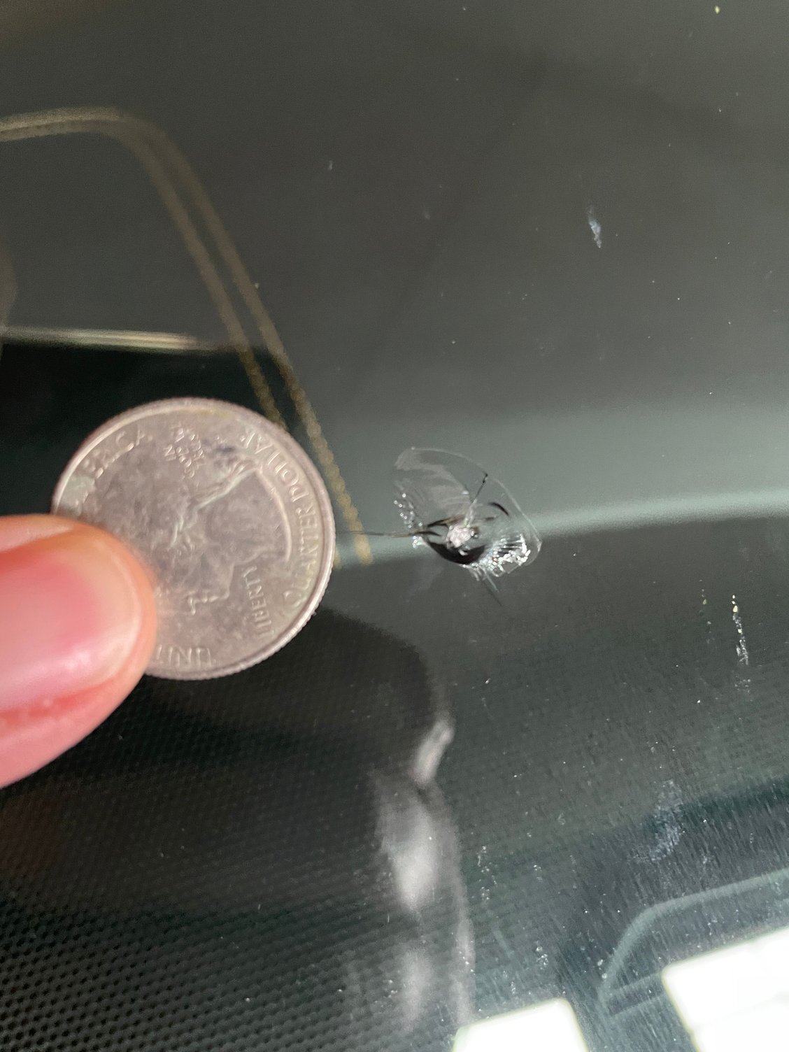

My new car caught a stone recently. The damage looks like it might be repairable. My insurance told me it was my option if a repair is possible to do that or replace it.
I have had different views on repair vs. replace. While repair is less invasive, it would still leave at least a slight mar that I might notice. If I do a replacement, the down side is that it opens the door to potential issues or damage.
Am I over thinking this?
Chip compared to a quarter

I had talked to the shop about this.
They said it should be done right away before crap gets into it.

I had one like this a couple of years ago. It was up high on the passenger side, so I had it fixed. It is still quite visible, but far from my line of sight and not even a concern from the passenger seat. I bought a new OEM windshield and new seals too. Ready for the next time if needed...

We have a glass repair shop that does excellent work. 5 star reviews and family and friends have gone there. That’s a big chip and it looks like it could get worse over time. Insurance should pay to replace the windshield. Peace of mind and you don’t have to look at that ugly chip.

I don’t think you are overthinking it Jim. I would try repair first. The more you get done the more chance there is for damage to occur. I would get it repaired and if you are then not happy with how it looks get it replaced.

Ugh yes that does make a difference, however personally I don’t like to replace original parts unless absolutely necessary and I did have a stone chip repaired on my S and you really, really had to look at it at a certain angle to notice the repair and I have o.c.d. and anything that is out of sorts always drives me crazy.

It is a big chip but I get your apprehension of a replacement. I had my 2017 Pilot windshield replaced before a 1,000 mile trip to California from Colorado, and they/Safelite didn't use the correct weather seal. It was noisy all the way there. I had them do it again once I got to California.
I had a chip "repaired" on the 2005 NSX, again by Safelite, and it didn't make any difference. It showed a few day afterwards. I've left it as I really don't want to have that worked on.

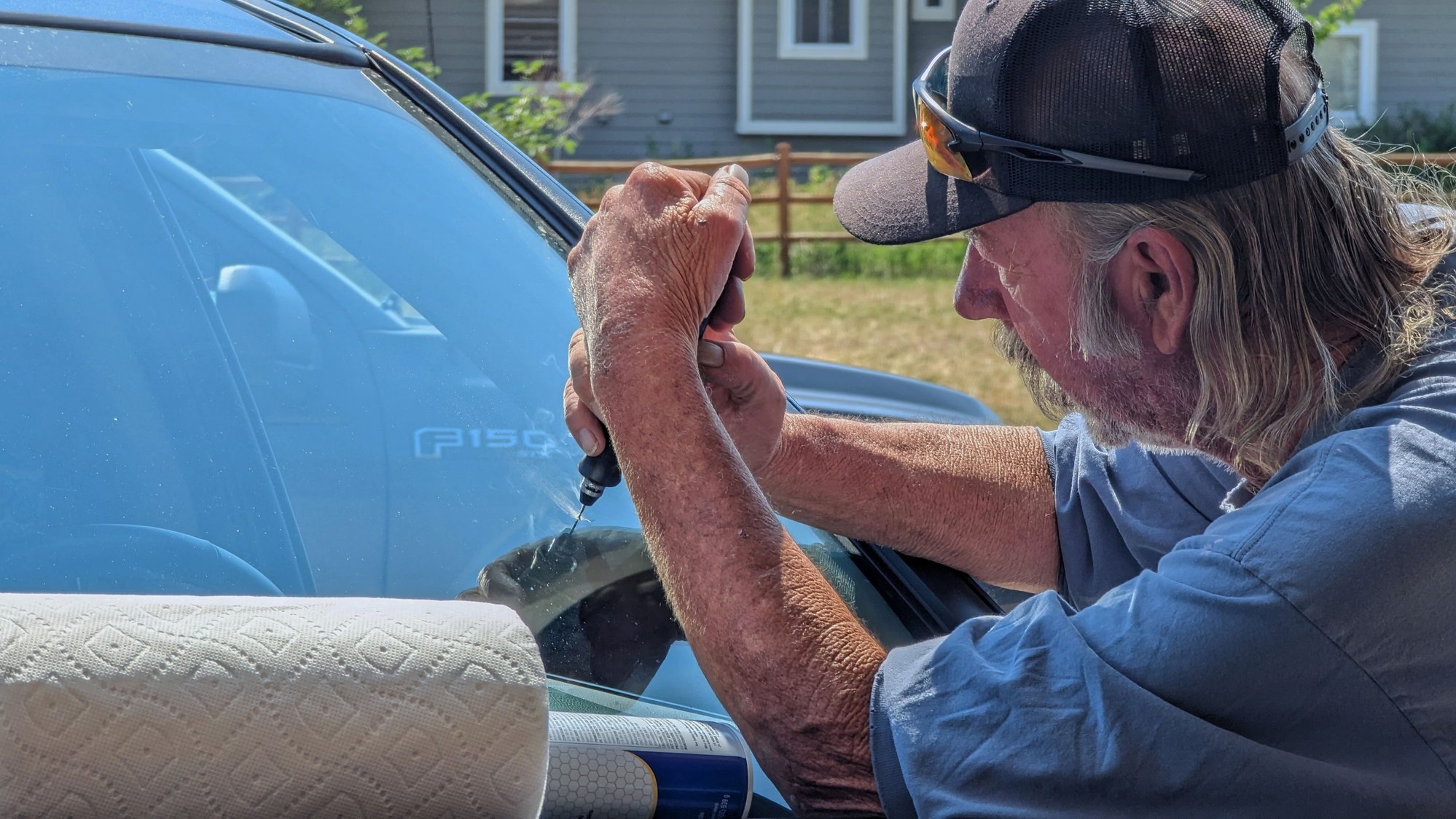

The man in the photo who did my Pilot a few times told me that you have to drill out the ends of the "stars" or cracks to stop them from spreading, before you put in the glue/cement. I think he is right! When Safelight showed up to do the NSX I asked him about that and he said it wasn't necessary. His repair didn't work. I don't like Safelight. They are too big and even getting ahold of them is a royal PITA. I could never get a person on the phone. It was all online. They didn't have the options I wanted.
