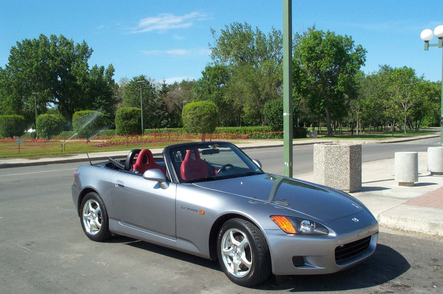

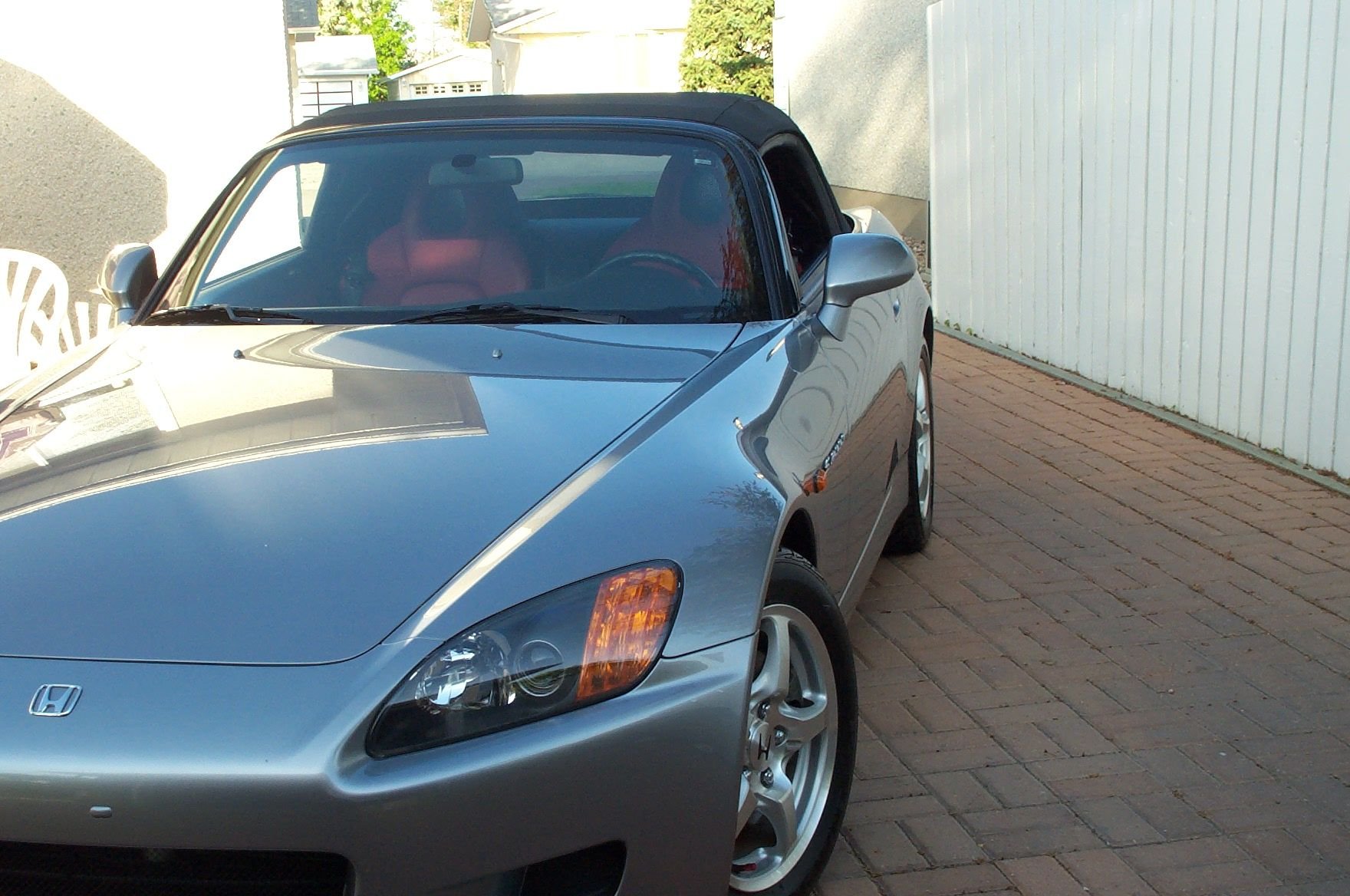

This weekend I decided to tackle the polishing of my silverstone S2000. I recently got the PC. The first try I was not happy with the hood, I used the white Lake country pad with swirl remover. This weekend I washed the car, from top to bottom with dawn, and went to it. I used Megiuars swirl remover with the yellow pad. Still quite nervous but I had it on 3-4 speed. Polishing and Waxing the car took me 2 days.. about 12 hours. I am slow and quite meticulous. I am including before and after pics, plus one from 2 years ago, however it is really hard to tell any difference. The difference is there especially in person.

wooo! congrats! looks great!

yup, looks good to me too!
really hard to get photos of silver-
but your aft pics have a bit more "pop" to them, imo.
