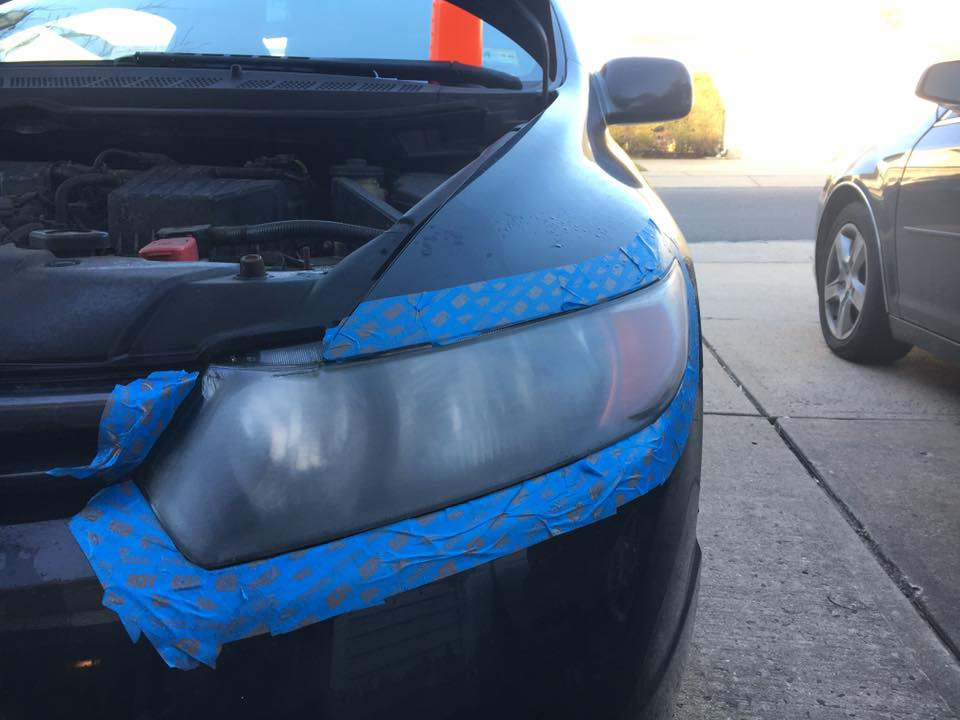

Sounds like your passenger side has light haze from oxidation. But if it's only at the top, then you may not see much improvement in the light output even after polishing. It's not worth to pay a shop to do this.
Here's a picture of headlight restoration I did for a friend recently (there are DIY kits for headlight restoration as well, but I've never tried any)
- Wet sand using 800, 1000, and 1500 grit sand papers
- Compound with M105 then polish with M205
- Coat with UV resistant clear coat (most important step)
