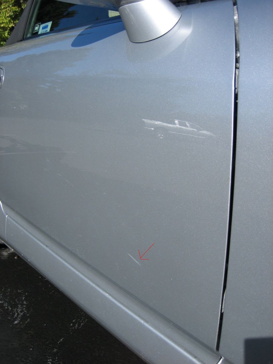

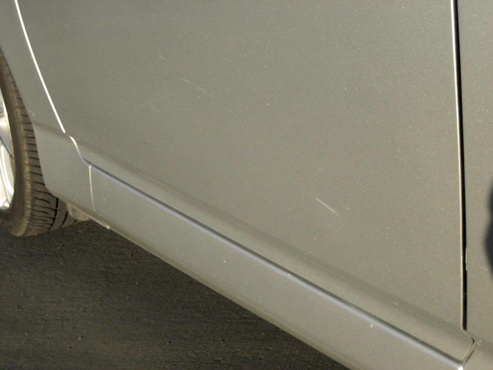

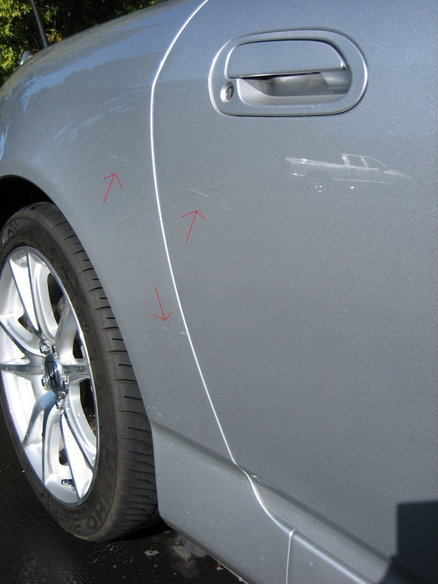

I went to the track for the first time a few weeks ago. Lots of fun, but in my newbie-ness I pinched a turn and ended up in the dirt, going sideways at a pretty good speed. In addition to filling my car with dirt, which I'm still finding even after a fairly thorough vacuuming, I got several good scratches on my passenger side. Do you think there is any chance I could work these out? Would I need to do some serious polishing, perhaps wet sanding? Or am I pretty much screwed. Any advice is appreciated.
Not the best pics, but maybe you get the idea? These were taken a day after washing the car.

Carefully run your nail against the scratches. If you can feel that the scracth is "guiding" your nail then no, they are not going to come off. If you can glide your nail along the scratch without your nail catching the groove, then yes, some polish, possibly even some wetsanding are required.

Thanks. I sifted through more of the info in the forum... lots of good info. I can feel the scratches when I run my finger nail over them. My Sat. is looking pretty free so I'll try to do a wash/clay/polish/wax and see where that leaves me. I picked up some Meguire's scratch remover. I have a feeling that I'll still have at least some of the scratches, but we'll see. This is my DD and there are several other visual imperfections on the car so I'm not gonna flip out over it, but I'll see how good I can make it look.

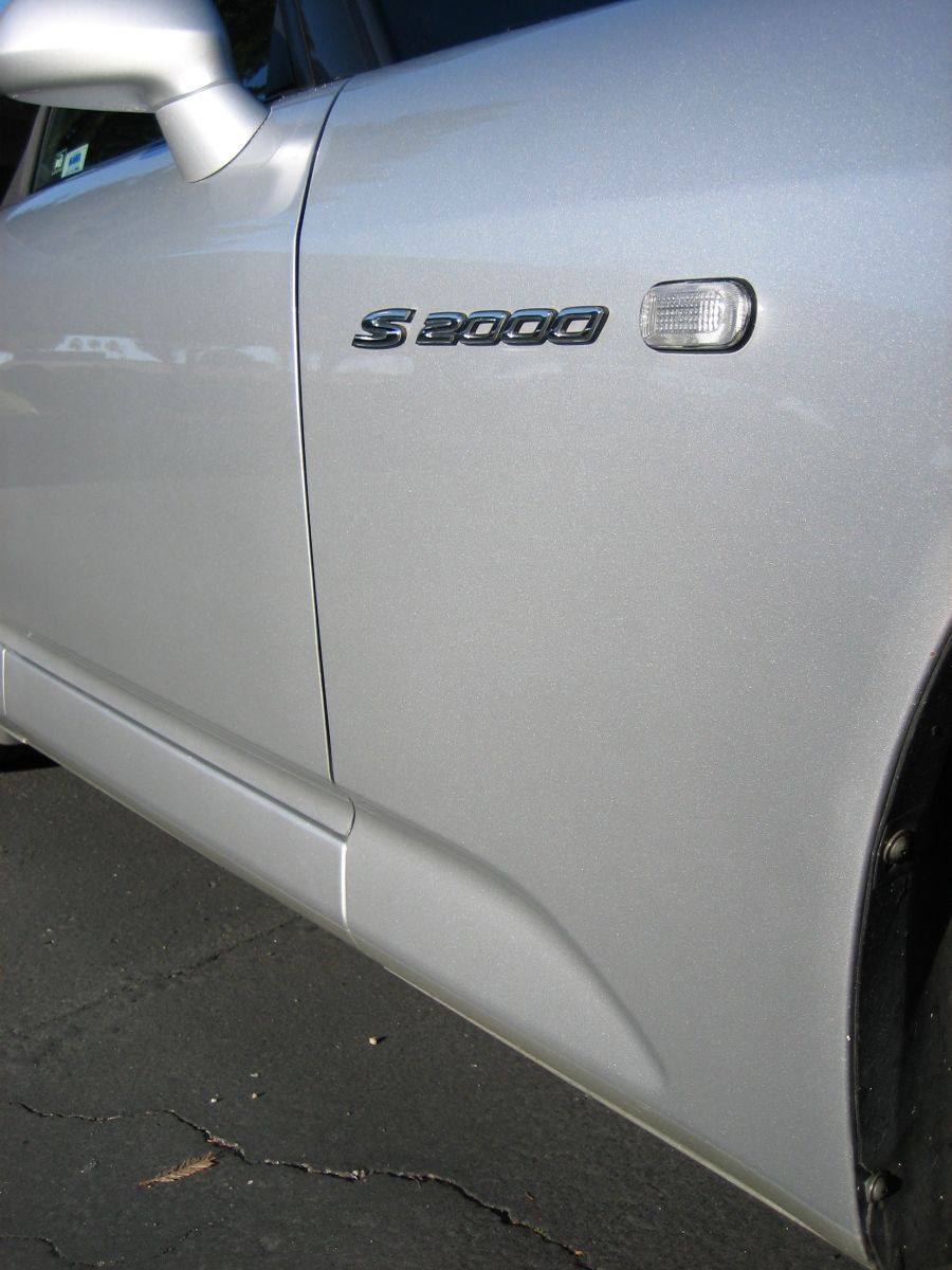

So, I had a go of it on Sat. and I'm pretty happy with the results. I washed the car with Dawn, and then used 3M Scratch Remover on the scratches with a terry cloth. I then clayed and waxed the car. In total I spent nearly 5 hours (time flew by!) and I could have easily spent another couple, but I had other stuff to do. Because I was trying to move things along somewhat quickly, I didn't take much care with the photos, but hopefully they get the point across.
Scratches after the wash (click twice for the up close and personal view):
Here is an example of a before and after with the 3M Scratch Remover:
In real life, it wasnt' perfect, but it was much improved. It didn't take everything out immediately, but after I clayed and waxed, I was very happy with the results. I don't know if you wackos would be satisfied, but I thought it was a pretty good improvement.
Here is after the wax:
And the finished product:
Actually, after the wax, I didn't take a real hard look to see if I could find the scratches. But if you don't know what you're looking for, you won't see anything.
