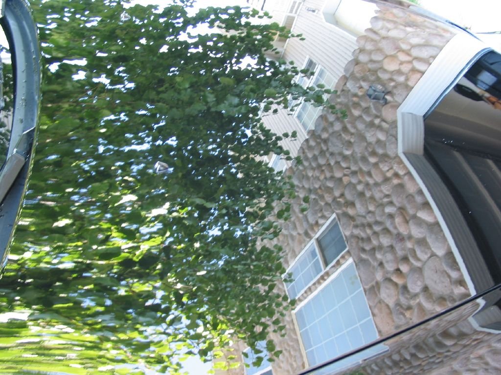

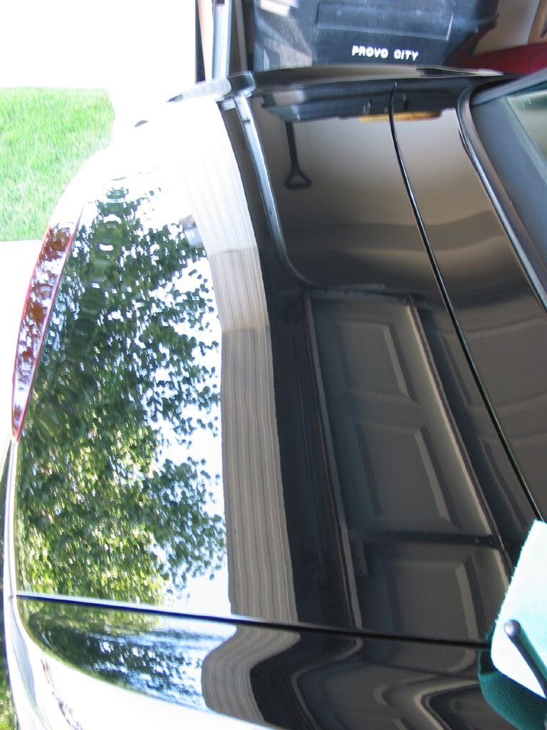

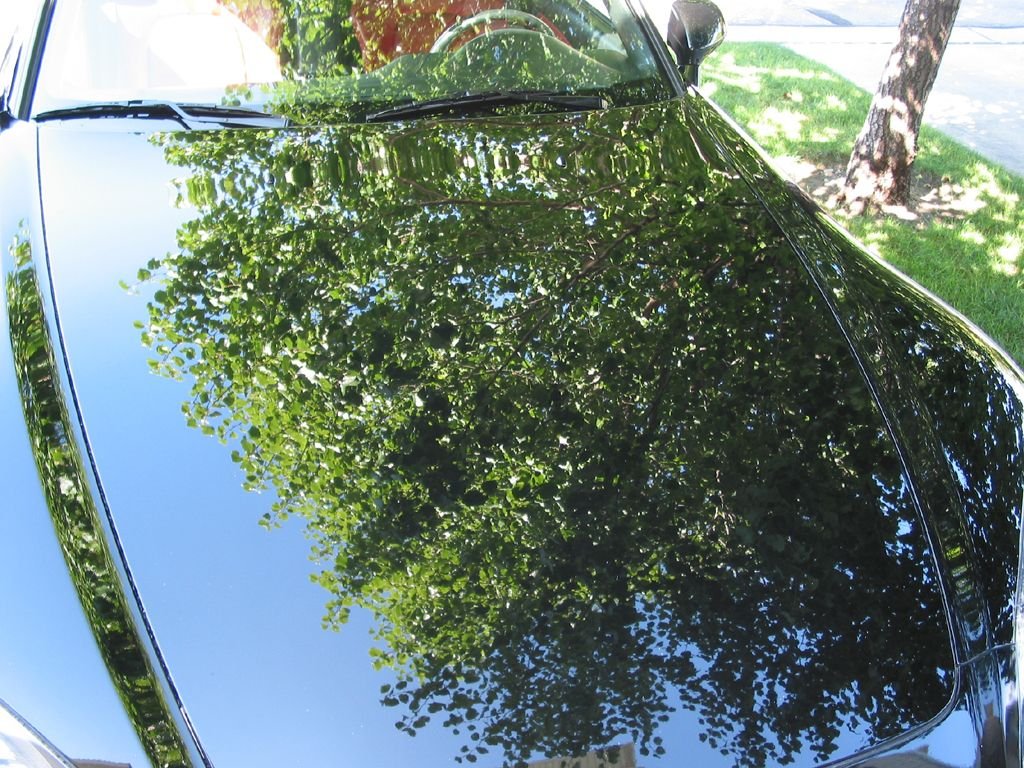

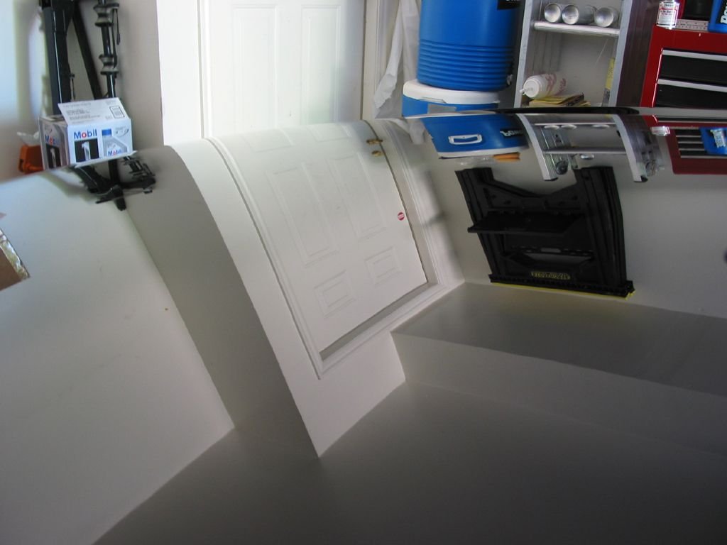

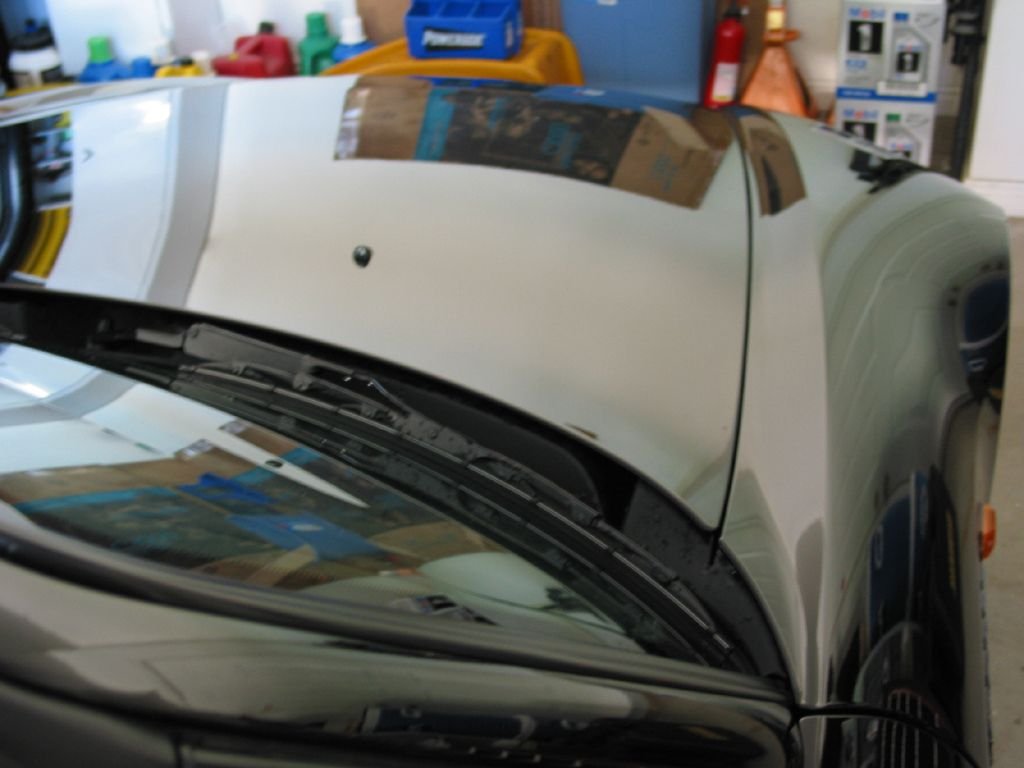

Finally got a chance to wash and apply a second coat of s100. A couple of shots aren't in the best focus, but I think you get the idea. This is a 3 yr old car with 25K+ miles on it, although she is a garage queen Photos were not altered in anyway, only resized down to 1024X768
