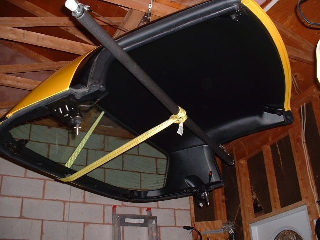

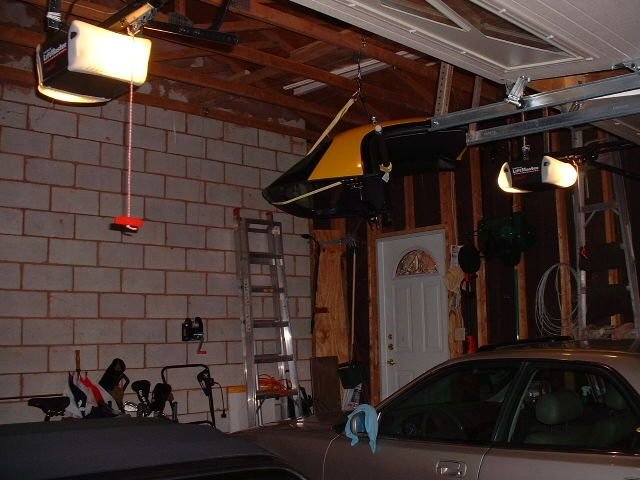

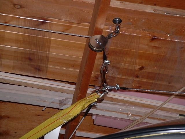

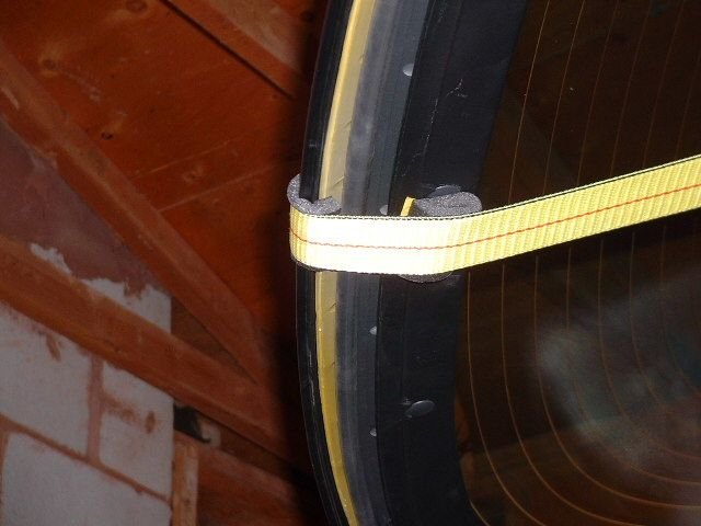

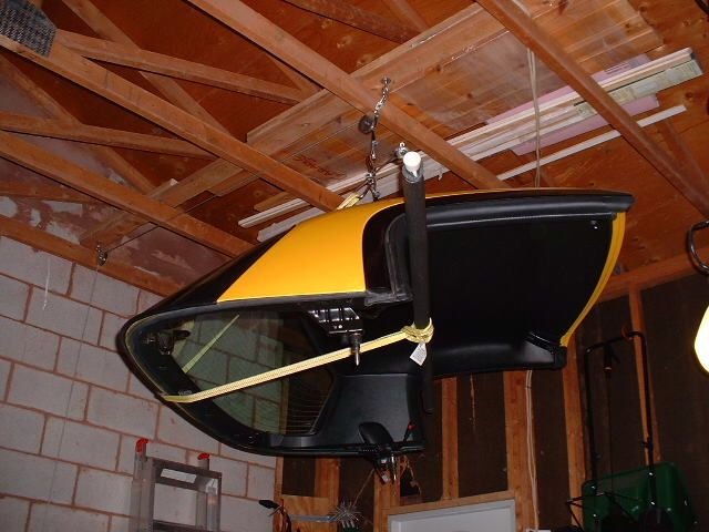

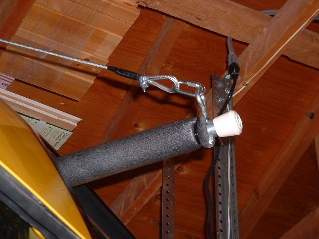

OK, we'll try this pic posting thing one more time. Can't seem to get more than one pic to post at a time
See Nimesh, I have the top for my elusive car.
Shot of the centre hoisting rig.
3/4" elec conduit with 1/2" thick foam insulation.
Worm gear winch, works great with a cordless drill attached.
Winch boy!
Old Sep 13, 2004 | 04:29 AM
wing's Avatar
Joined: Sep 2003
Posts: 7,620
From: Ottawa
Nice, interesting that little hook can hold the weight, when I did mine I had 4 hooks to distribute the weight and one of them snapped so I gave up and made a stand instead.
