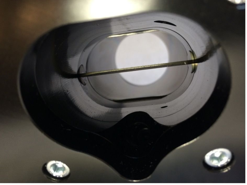

  • Shaftless throttle design for best flow (similar flow to much larger throttles improving air velocity)

Picture of shaftless throttles

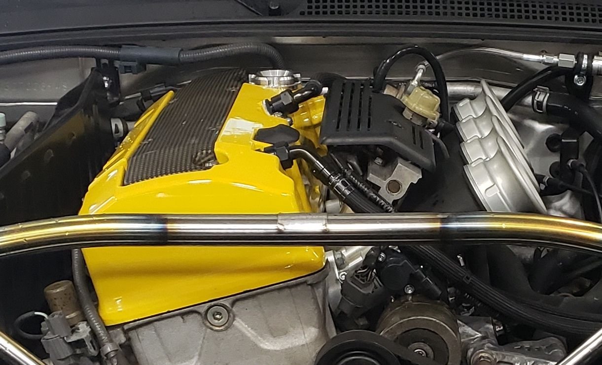

Uses OEM fuel rail to lower cost, maximize plug and play and simplify injector selection by using OEM or S2000 aftermarket injectors
