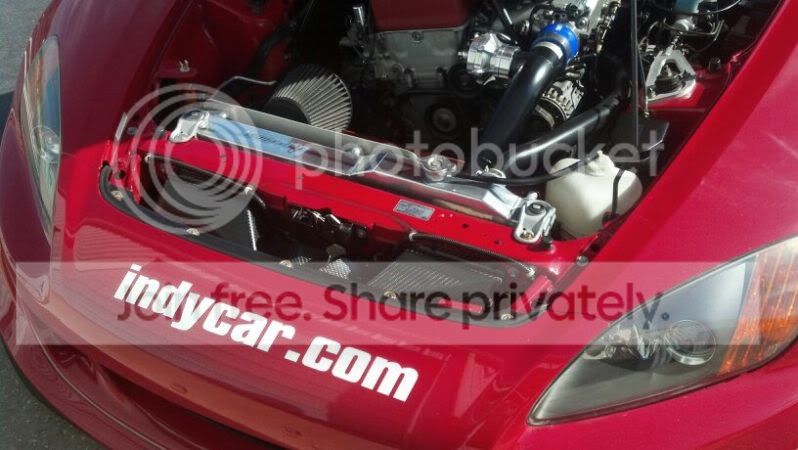

Last time I was at the track my brakes were heating up quite a bit. I decided to make my own brake cooling ducts. I wanted to buy those new WASP Composite ones, but they wouldn't fit with my intercooler piping and oil filter/thermostat location. I ended up making my own out of carbon fiber. I also modified my dust shields to accept the 2.5 high temp silicone hoses.
Here is a close up of the duct in the front bumper... it was hard to take a good picture...looks a lot better in person.
I also decided to make my own cooling plate designed after the stock air guide. I never really like the ones that mount on top of the support. I think this looks like it came this way!
After all this, I finally got around to making a shroud for my SPAL fan instead of using the universal mounts.
Heading to the track next week... hopefully the brakes perform better than last time!!
