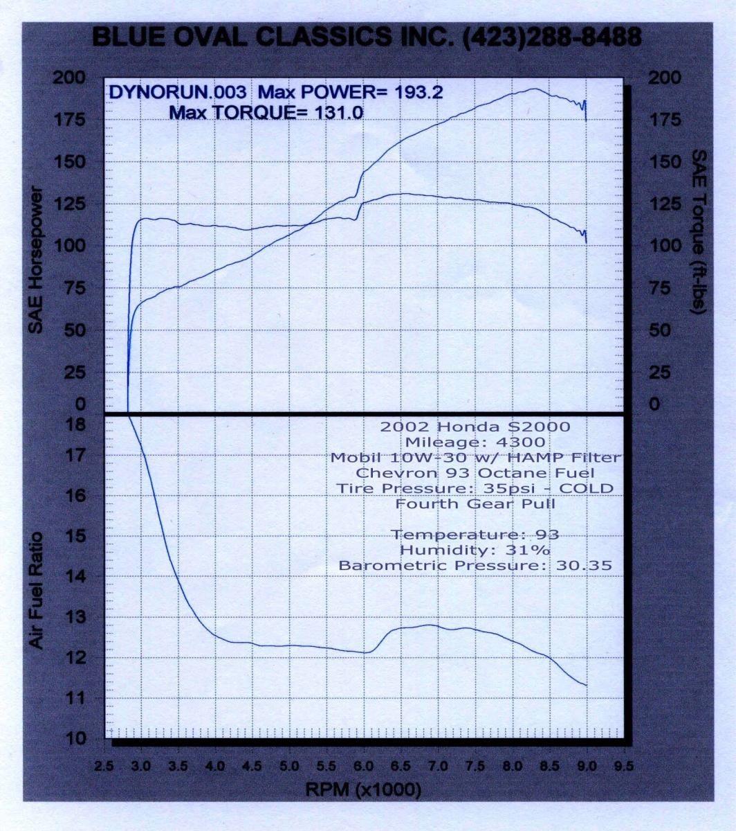

Spoon does not make power either for the 2.0L AP1 engines - see my dyno charts:
Baseline:
Baseline vs. Spoon modifications:
The only advantages that I saw were the decrease in weight, plus the N1 sounds really good in VTEC, but not worth the money and significant loss in mid-range. It actually make the VTEC transistion feel a lot smoother, making your butt-dyno think you're making a lot more power.
