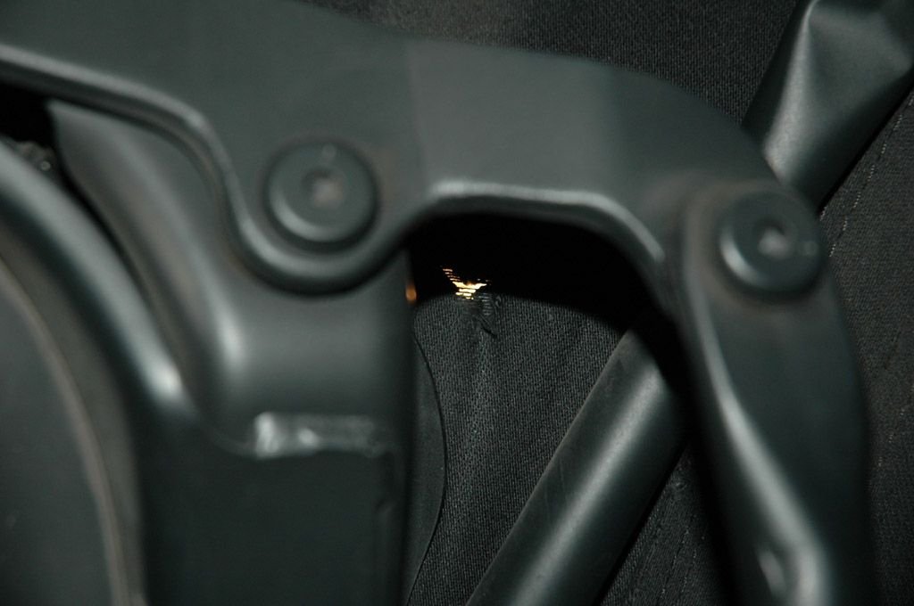

Hi All. Does anyone know of a good place to go to change out the rear plastic window with a glass window? The plastic window has a cut in it and I don't want to spend 1800 for a whole new top (like the dealer says I MUST do). Some reason, I just don't buy that. Thanks for the help!

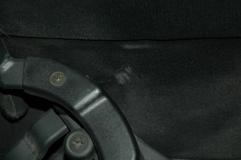

The OEM top w/plastic window has a few design flaws that result in premature wear around the frame hinges. The '02-'06 versions have a plastic shield to protect the top material from the frame points. You'll want to replace the whole top anyway. AHM assisted in the cost of replacement because of these problems. I replaced my '00 top with a new OEM glass window version (from hardtopguy) using the DIY instructions on this board.
The Robbins top is a lower cost solution. The OEM glass retrofit takes about the same labor and a couple extra pieces of elastic and nylon webbing riveted to the frame.
I believe First Texas Honda uses J&H for factory replacement labor. J&H can offer you the Robbins top. Their quote was fair but I opted to go DIY.
