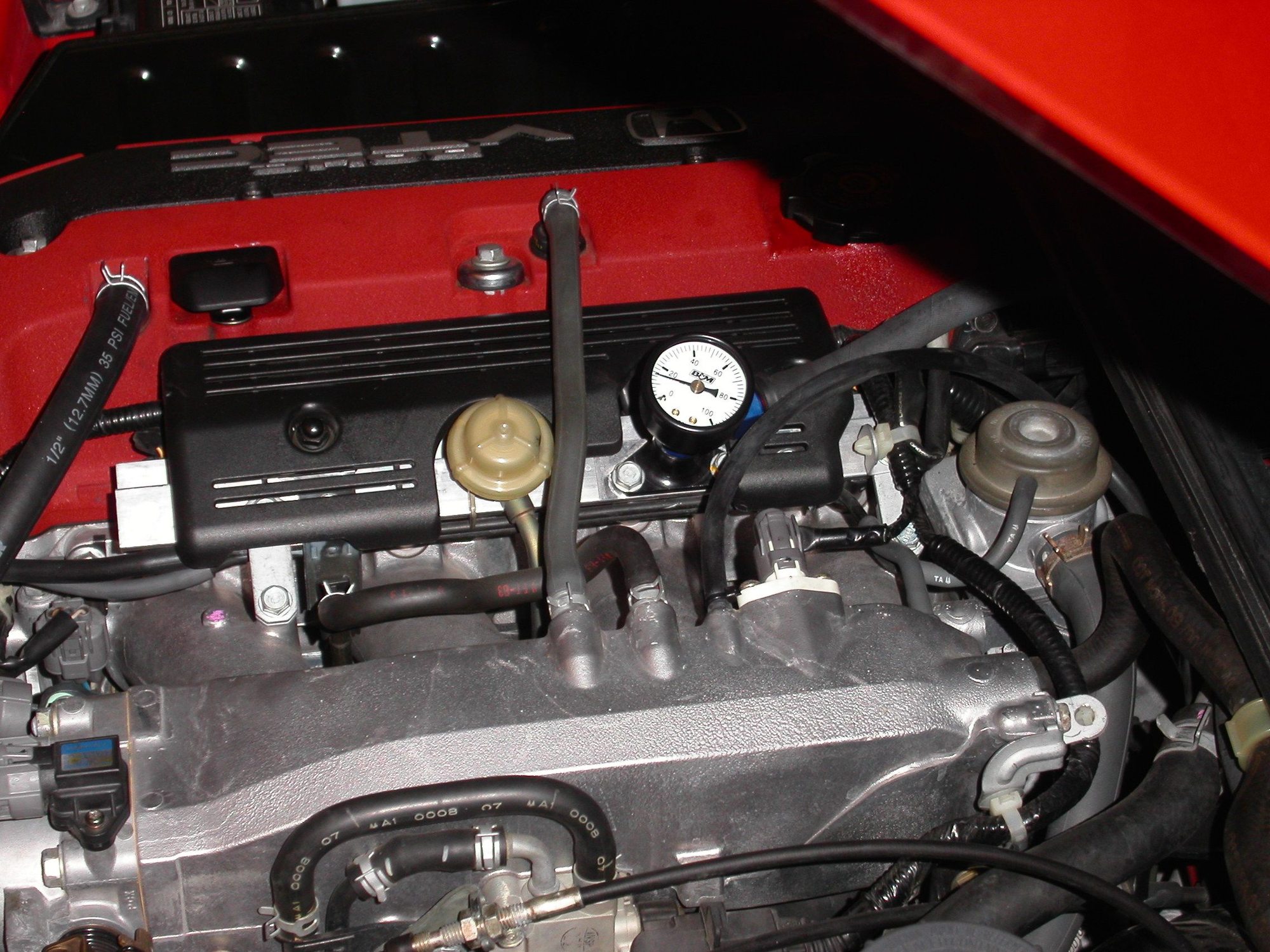

B&M makes cheap easy to install fuel pressure gauge. Here it is installed on my ex S2000. I agree with Altian, fix the knowns and the unknowns will often fall in line.
